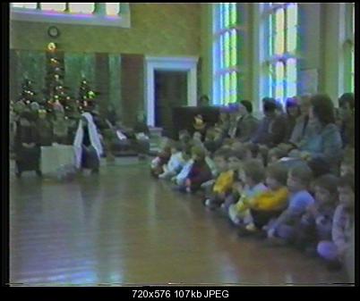

    So i'm in the middle of capturing my VHS home movies collection, i've done the best i can with the budget i have (captured in huffyuv, passthru with Panasonic ES10) and was wondering how best to go about post capture cleanup/restoration.
    Here is a sample snapshot with VLC to show you the quality i am working with (bare in mind this came from an old VHS tape from mid 80's)

    I know there isnt a great deal i can do with the actual quality, but i was thinking something like colour correcting etc... I was wanting suggestions on maybe software, and your ideas on what you might do with it if it were your video as i've never really undertaken something like this before and thought maybe some of you guys might have in the past or even currently.

  2. Is this a first-generation tape? It looks like a copy. Even an EP (6-hour mode) VHS tape doesn't usually have details that are this "muffled."

    I cant be 100% sure as i was only around 3 years old when this tape was made (one of the kids in the pic), but i do know the camera it was taken on wasnt great. I do know the tape i have is recorded in SP (3-hour mode).
    The screenshot isnt the best though, when its actually moving it looks a little clearer, plus its interlaced and i didnt turn de-interlace on in VLC.
