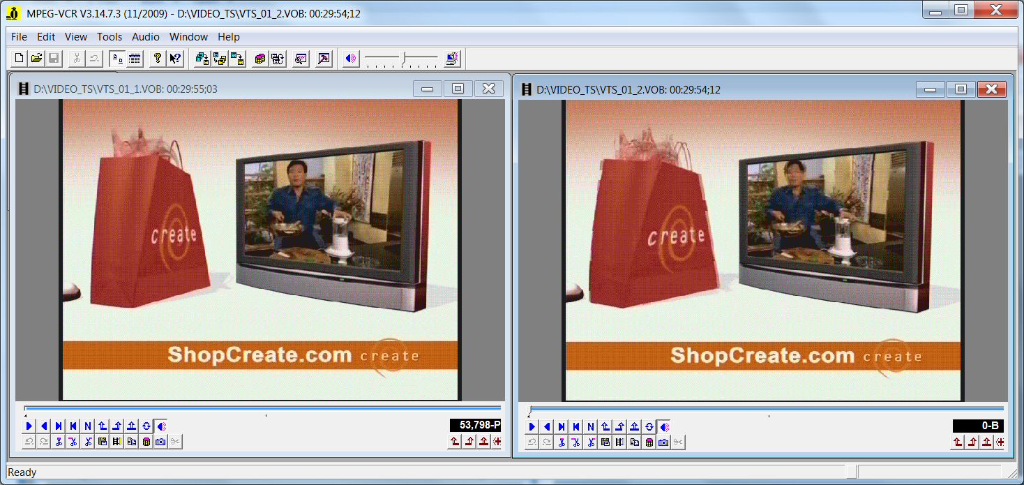

    You are mistaken in assuming that AVIDemux can do all that needs to be done. You need to join the VOBs into an mpg before editing using a program designed to do that. There is something you don't realize, namely adjoining VOBs in the same VTS don't always end and start with a complete GOP. This means that when a video spans VOBs, some frames can be lost when joining two VOBs inside an editor, even though you have added them in the correct order.
    Editors cannot know that the VOBs are related, and the incomplete GOP at the end of one GOP and the incomplete GOP at the beginning of the next VOB are two parts of the same GOP. They will treat them as unrelated files with incomplete GOPs, and will discard the incomplete GOP at the start of the second VOB. They may also discard a couple of B-frames at the end of the preceding VOB's incomplete GOP.
Name:	Spanned Video VTS_01_1 and VTS_01_2.jpg

    I tried to see what happens when AVIDemux is used to import VOBs and export ps or ts files. I didn't find that exporting the edited output as a DVD-compatible ps (allowing non-compliant streams) or as a ts (with VBR muxing) takes an unreasonable amount of time compared to other editors I use. I also confirmed that if using "Copy" for both audio and video, the video isn't re-encoded, and the audio seems identical to the original AC3 too. Using the same priority, exporting as ps or as ts took about the same amount of time. I have no explanation as to why there is little difference in processing time for my computer and not yours.
    I was surprised to find that AVIDemux does provide a way to correctly join video spanning multiple VOBs with no missing frames. The first time a user opens a VOB in a VTS, AVIDemux asks: "There are several files with sequential names. Should they all be loaded?" If the answer is "Yes", the VOB and all the VOBs following it in the VTS are loaded into the editor, joined together in sequential order. Unfortunately this only works on DVD files and folders on an HDD. It doesn't work for ISOs mounted on a virtual drive or actual DVD discs. In those two cases, AVIDemux cannot write the idx file in the same folder as the VOBs, and I can't find a way to change the location where AVIDemux writes the idx file.
