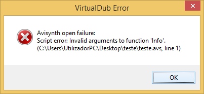

    i reinstalled avs+ 64 and now it displays following message when playing a mp4 file through avisynth
    http://pastebin.com/LWVaDaJP

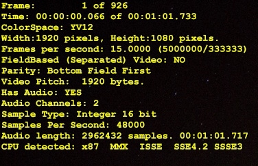

    it seems its a MPC HC issue, avisynth scripts now play with virtualdub, tried disabling the internal filters in MPC HC but no luck.
    I love it when a plan comes together!

    Use a simple script like:
    DirectShowSource("filename.mp4")
    Info()
    with mpc hc it only plays audio, with virtualdub plays fine, shows this:
    [Attachment 39195 - Click to enlarge]

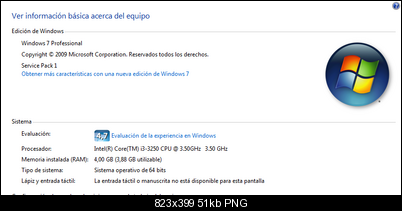

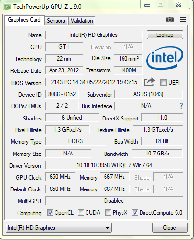

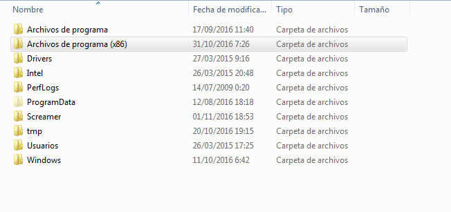

    Originally Posted by ricardouk View Post
    (...)remanyao, have you tried 8.1 64bit before? not worth upgrading?
    No.
    While my windows 7 (x86_64+RAM 4,00 GB) has support, I'm not going to change.
    No need to change it, is all I need.
  23. Member ricardouk's Avatar
    Mar 2005
    Portugal
    You got me confused (x86_64)? you're using windows 7 32bit on a machine with a 64bit processor?
    my main problem is 4k lossless footage, when i used avisynth on 32 bit OS the conversion stoped after 1min, not enough memory (i have 8GB RAM), Gimp when stacking a lot of images would stop as well, on 64bit it flies through without problems, its just avisynth...
  24. Member
    Aug 2013
    Argentina
    Yes.
    The Platform, C:\ (Program Files x-64/ Program Files x-86), the machine:
