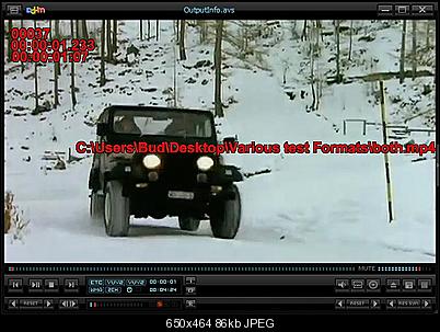

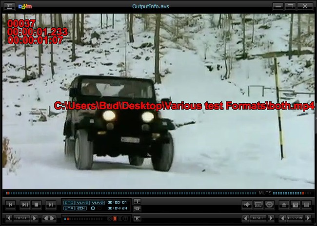

  4. Member Budman1's Avatar
    Jul 2012
    NORTHWEST ILLINOIS, USA
    You can use an AVISynth script to display the frames and times. I use Potplayer because it allows step forward and backward but any player that will allow this and honor Avisynth will work.
    Script is thus
    DirectShowSource(("C:\Users\Bud\Desktop\Various test Formats\both.mp4"), Pixel_Type="yuy2").Crop(0,0,-0,-0)
    Subtitle("C:\Users\Bud\Desktop\Various test Formats\both.mp4", x=640, y=200, font="Arial", size=24, text_color=$ff0000, align=3)
    ShowFrameNumber(scroll=true, x=10, y=27, font="Arial", size=24, text_color=$ff0000)
    ShowTime(x=72, y=44, font="Arial", size=24, text_color=$ff0000)
    ShowSMPTE(fps=30, x=68, y=61, font="Arial", size=24, text_color=$ff0000)
    Results in Click image for larger version
Name:	ScreenHunter_200 Oct. 25 22.37.jpg
