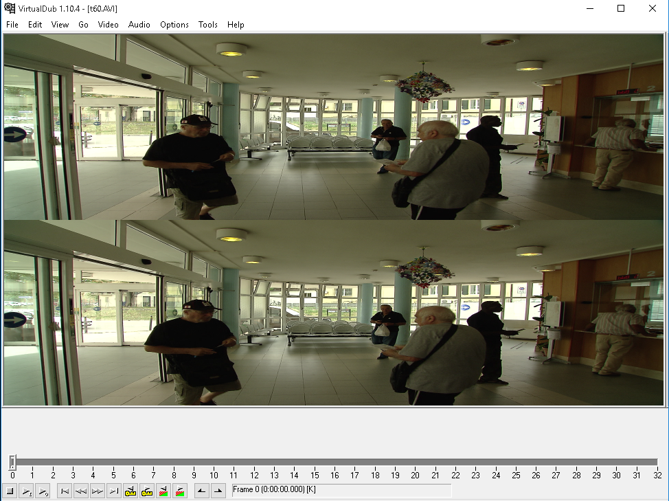

    I have a .avi file uncompressed that in virtualdub is open as this
    [Attachment 39041 - Click to enlarge]
    please can I achieve a "normal" image? thanks

    VirtualDub top menu.
    "View" --> disable "Arrange video panes vertically".
    Then right-click anywhere on the image and in the right-hand side of the resulting menu, click on "16:9" at the bottom of the window.

    maybe an 'over under" 3D video ?
  4. mm I think the problem is another. I see this type of uncompressed file is shown "doubled" in virtualdub. Also avisynth read it bad. I wonder if is there a way to "merge" the 2 images so that I can see the full frame as right
    [Attachment 39054 - Click to enlarge]
    ps: I attach the .avi file uncompressed (only 10 frames) if you do some proof

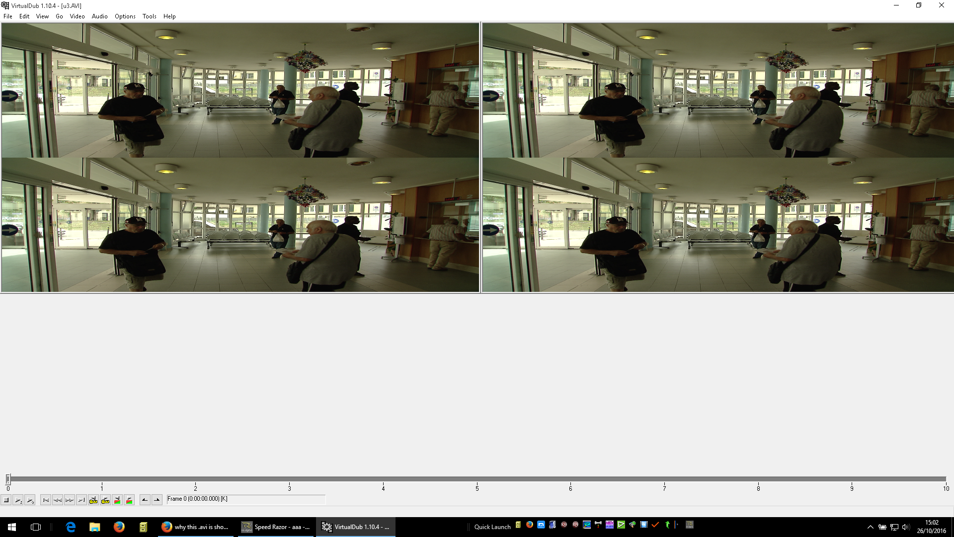

    [Attachment 39056 - Click to enlarge]
    a=AVISource(u3.AVI")
    t=a.Crop(0,0,0,-540,true)
    b=a.Crop(0,540,0,0,true)
    Interleave(t,b)
    AssumeTFF().AssumeFieldBased()
    Weave()
    Seems work a little but in hardware playback is jerky.
    Possibly it should have something like this uncompressed (in a different "normal" mode) like this u3ok.avi attached ^^

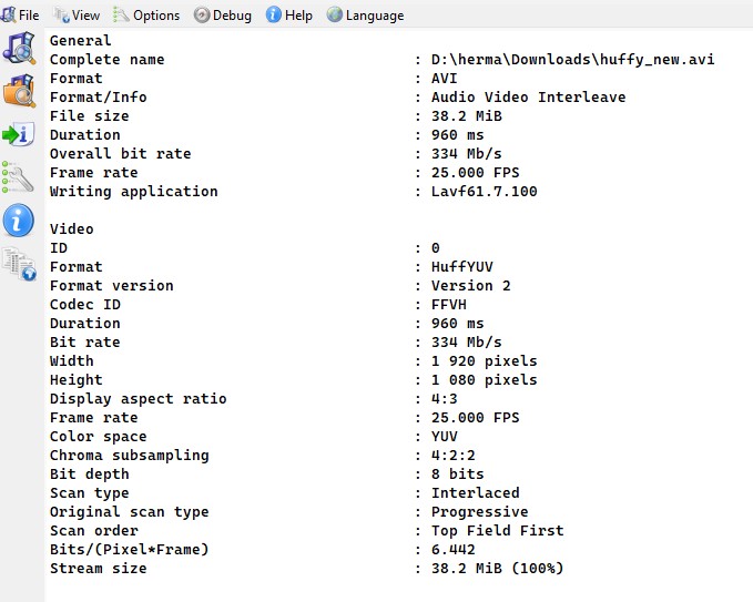

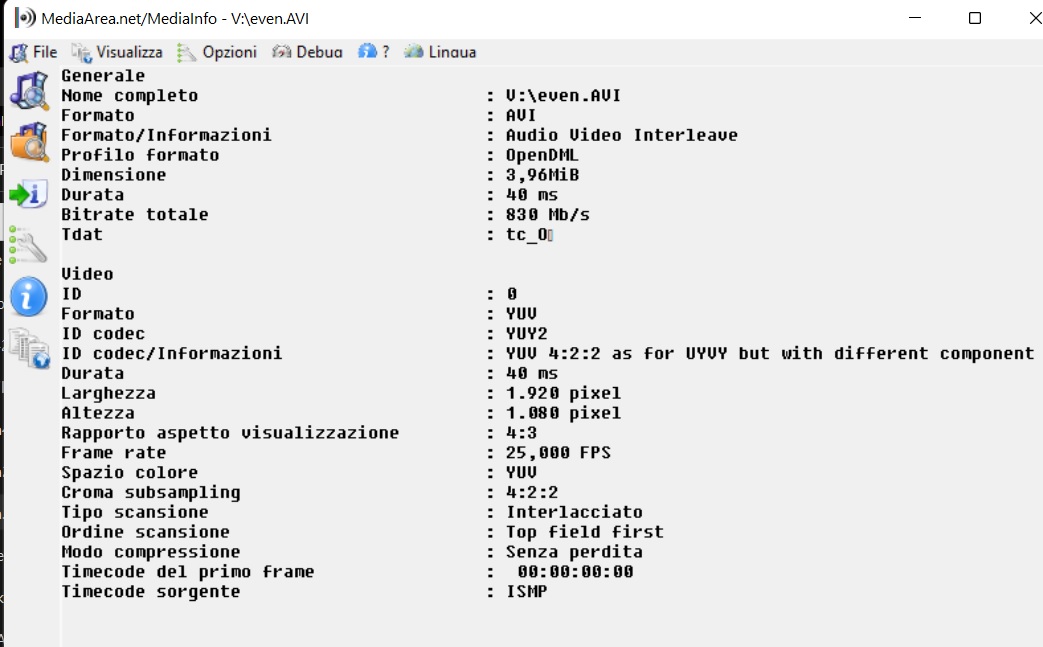

  26. no simply cat experiment
    I wonder if is there a way to write, using virualdub, a .avi file uncompressed that mediainfo see as "interlaced" like my
    [Attachment 88148 - Click to enlarge]
  27. Do you mean something like this:
Name:	Screenshot 2025-08-05 235122.jpg
