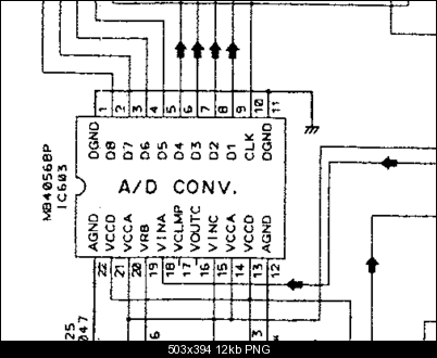

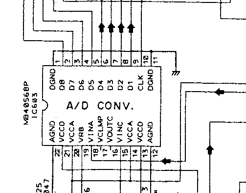

    I was looking through the LaserActive schematics today looking at good points to hook in for clean analog signals, and I spotted something interesting:
    Remember how I said the LaserActive has a digital buffer? Well it turns out that whether that buffer is being used or not, the video signal is always converted to digital. I had thought this would be hidden inside some proprietary chip, but in fact it's done through this simple standalone ADC, an MB40568. This is an 8-bit ADC which is designed for composite video work, so that goes to show 8-bit seems to be enough to get a reasonable picture, provided the analog input signal has been prepped appropriately. I probably would have found it hard to work out the circuit to do that, but fortunately in this case I don't need to, because all the circuits are already in place for that inside this unit. Seeing that little chip in there already doing the heavy lifting for me, I figured why not try and capture a digital signal rather than an analog one? Turns out that ADC drives an output at around 20MHz, well within the capture range of a good logic analyzer, and fortunately my totally legit (and not at all a cheap Chinese clone) Saleae Logic 16 can endlessly stream 9 digital lines at 32MHz. That allows me to capture all 8 data lines, plus the clock input. All I needed to do was solder on some attachment points, generate a massive data capture log, knock out one dodgy program to scour the data for clock transitions to get the real data samples, and then using the RawSource method jagabo shared (thanks for that!), and here's what I got:

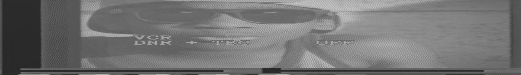

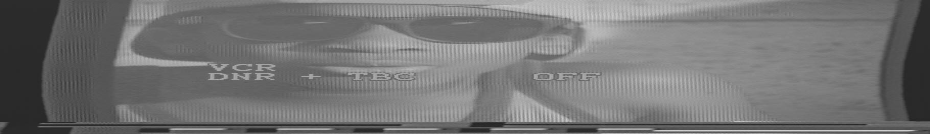

  6. I've had some success with lining up the sync pulses in software. A sample of PRE_Home_Alone_MV_1_-TBC loaded with RawSource():
    [Attachment 39240 - Click to enlarge]
    Obviously, the picture is badly bent. Again, the actual line length in the samples is somewhere around 1820.05 pixels and RawSource() is reading 1820 per line, so the picture would slowly slough off to the right (as in post #27) if it wasn't so bent (you can see it if you zoom into the chroma subcarrier in this picture).
    After alignment on the falling edges of the horizontal sync pulse:
    [Attachment 39241 - Click to enlarge]
    I've made not yet made any attempt to adjust the length of each scan line, just copying 1820 pixels starting 8 pixels before the sync pulse (so the falling edge is visible). I'm just using the first sample that falls below a threshold as the trigger, then subtracting 8. Better results could probably be attained by upsampling, smoothing, and interpolating the waveform to get a more accurate trigger. The rising edge of the sync pulse is sharper and would probably work better but the chromaburst signal is contaminating it a bit. It would probably work after removing the chromaburst.
    The chroma subcarrier is added to the signal (by the VHS deck) after it's read off the tape and isn't aligned with the sync pulse. If you zoom into the first image you'll see that it's aligned with the cap, not the picture content. And its pattern alternates, repeating every other scan line. After aligning with the sync pulse a lot of moire artifacts are visible so the picture looks noisier. This wouldn't be an issues if the video was run through a comb filter to remove the subcarrier.
    The code doesn't adapt to changes in the sync level. It's hard coded for the sync level at the start of the sample clip. The different clips have different sync levels and levels that vary during the clips. The code doesn't work properly during the VBI so it screws the lines up in that region -- and doesn't sync through successive fields. And I've made no attempt to adjust levels to get a full range from blacks to whites in the active picture.
    In short, this is simply a proof of concept. It's a very long way from being useful.

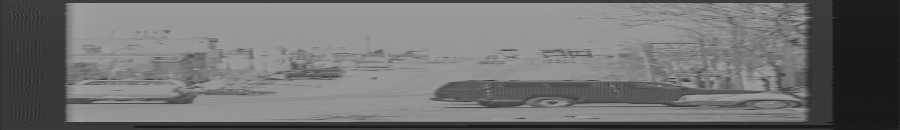

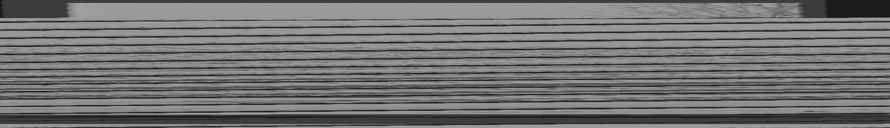

  7. I added a quick and dirty line length adjustment. Here's a field from CAM_Cardston-etc_2.4ta without any length adjustment (just aligning the end of the horizontal sync pulses):
    [Attachment 39265 - Click to enlarge]
    As you can see, the line lengths vary in groups, with most of them being too short. After adding line length adjustment:
    [Attachment 39266 - Click to enlarge]

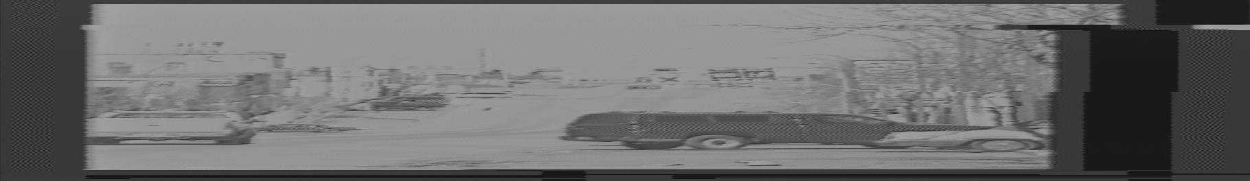

    Opening the same field in the original 4ta file with RawSource() gives:
    [Attachment 39273 - Click to enlarge]
    Once it reaches the short scan lines it loses sync and you get a garbled picture.

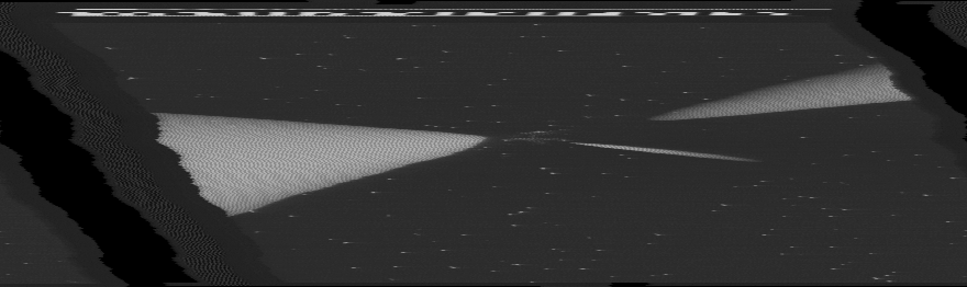

    I captured several fields worth of video from a DVD player using ms oscilloscope and transferred the data to a Windows PC. As a quick test I viewed the data by importing it into Audacity as 8 bit unsigned integers.
    Zooming into one scan line:
    [Attachment 39068 - Click to enlarge]
    Here you can see the horizontal sync pulse, the chromaburst, the actual picture content and finally the next horizontal sync pulse.
    Audacity seems to max out at 100kHz for the import dialog. I guess the only difference this makes when viewing the samples that I posted is incorrect timecode?
