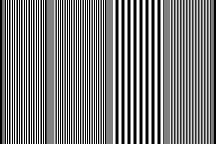

    I'll try and keep this short and sweet. I'm after ANY solution which will enable me to get a clean capture of all 525 lines in an NTSC field. Basically, I want a video capture that looks exactly like this (but for NTSC not PAL):
    http://foro.doom9.org/capture/images/syncpic.jpg
    Why do I want this? I'm ripping the analog video stream off laserdiscs that were used in various game systems, with the goal of emulating these systems in software. The disks in question encode important information in the vertical blanking region that is used by the hardware. They also encode separate video streams in the two fields, meaning it's much easier to work with separated fields than interlacing them, so I really do have a good reason to want to do an analog capture in this form.
    Here's what I've investigated so far:
    1. Off the shelf capture hardware
    On this so far, I've drawn a blank. I've got an old Canopus DVStorm capture card that I've been using, which gives a great image, and I can happily separate the fields from my capture, but I can't rip the blanking region with it. I haven't been able to find mention of any particular capture cards or devices that will output video for the blanking region. They might be out there, but hours of Google searches have failed to find a single device name which I can confirm will do this. I don't care if it's hardware aimed at home users, or high-end broadcast hardware, any name/model number of any device that someone can confirm to me is capable of doing this will be appreciated.
    2. Delaying vsync on the video stream
    I've taken serious looks at modifying the video stream itself externally to offset vblank into the image region, so that I can take two captures with different lines masked out, decode each frame into images, and merge the two in software. I can offset it on the screen on my Sony PVM using the H/V delay feature, which looks something like this:
    But this is for display only, the monitor doesn't pipe a modified video stream out. I tried my Extron DVS 304, but despite a lot of promising sounding features, it always strips the blanking content out of the input video stream, even though I can force it to output its own (empty) blanking content on the generated output video stream. It looks like the discontinued Extron IN1401 could probably do what I want, but I can't find one of these anywhere at this stage (though I've got alerts setup). I've also investigated building my own device to do this, but I can't find a chip that does what I want here either. Various devices like the LN1881 and EL4583 exist to extract sync information from a video stream without modifying it, but I have yet to find a clean way to actually remove sync information from a video stream. If I could do this, I could separate the sync, remove it, and try and run it through some kind of delay circuit to encode it back in at an offset, which would then allow me to pipe it directly into any capture card and capture the blanking region. If anyone knows of a device that can do this, or how to build a device that can do this, again please let me know.
    3. Taking a full analog capture of the video signal and decoding in software
    This would be my ideal solution, because it'd be more accurate and complete than an analog video capture. I'd do this happily, if I could find a data acquisition card/device that could do continuous streaming at around 20MHz at greater than 8-bit precision for under $1000. When I couldn't find this kind of a device, I seriously looked into designing and building it myself before I thought better of it. If anyone can point me at a solution in this area, it'd be appreciated.
    So that's it in a nutshell. I've tried to be brief and to the point. If anyone knows of any solutions here that could help me achieve what I want to do, I'd greatly appreciate your input. Thanks.

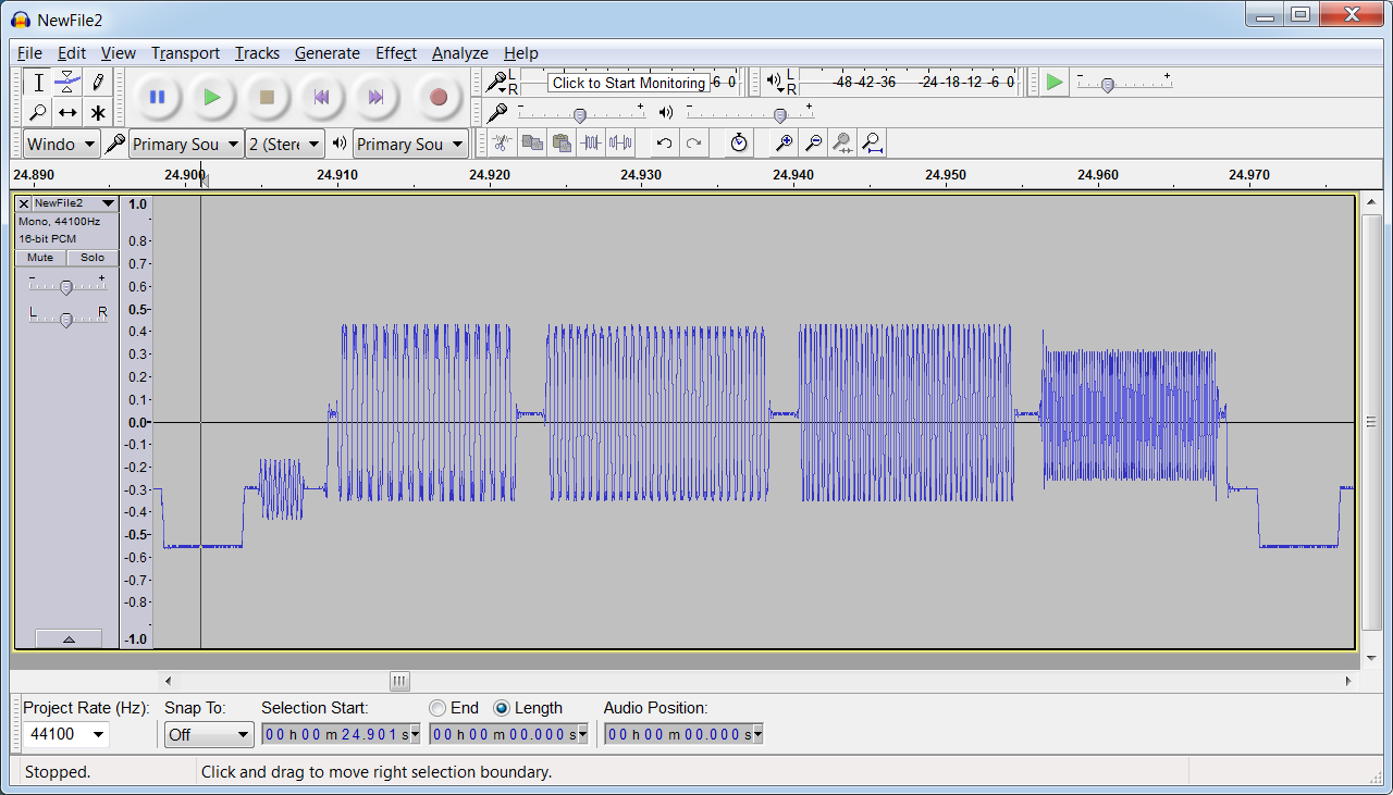

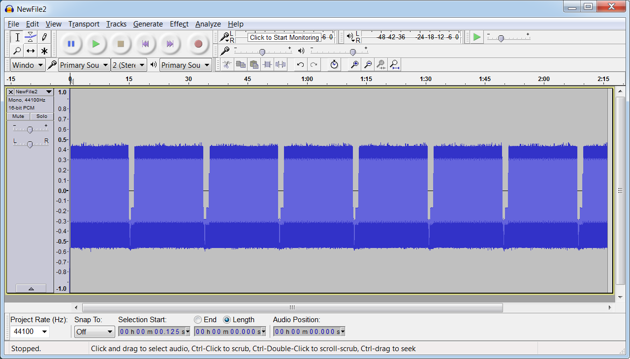

  25. I captured several fields worth of video from a DVD player using ms oscilloscope and transferred the data to a Windows PC. As a quick test I viewed the data by importing it into Audacity as 8 bit unsigned integers. Here you can see about 7 fields worth of video as a raw waveform:
    [Attachment 39067 - Click to enlarge]
    The dips in the waveform are the vertical retrace periods.
    Zooming into one scan line:
    [Attachment 39068 - Click to enlarge]
    Here you can see the horizontal sync pulse, the chromaburst, the actual picture content and finally the next horizontal sync pulse.

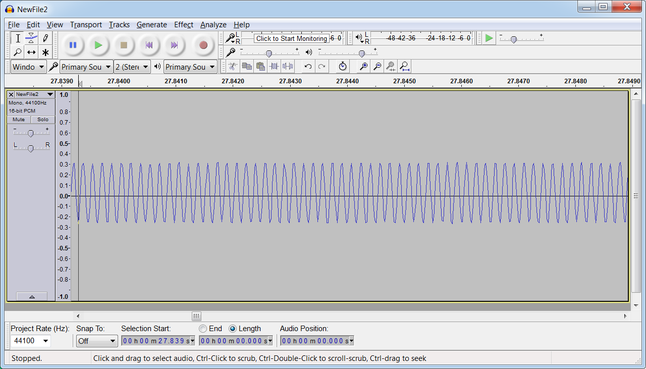

    Zooming into a small segment of the scan line (the picture here is alternating black and white 1 pixel wide vertical lines):
    [Attachment 39069 - Click to enlarge]

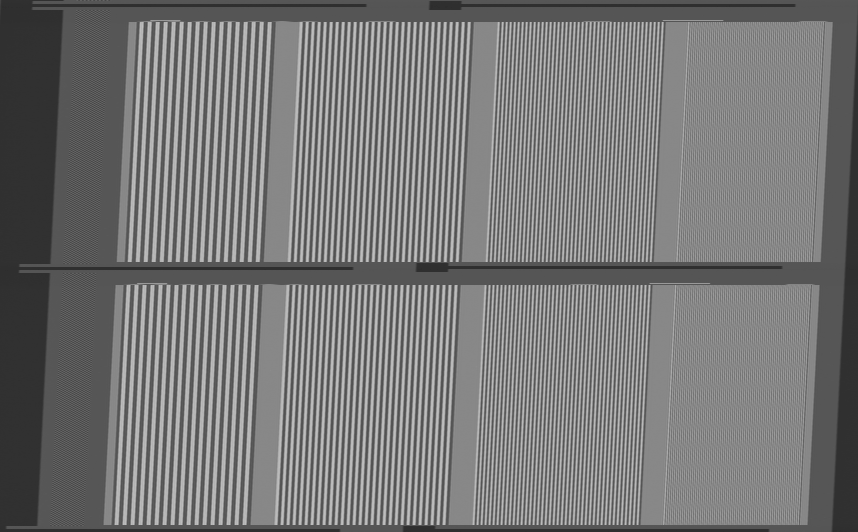

    Here are ~two fields of raw data imported into AviSynth using RawSource() and resized to 858 pixels wide (leaving the actual picture content 704 pixels wide):
    [Attachment 39070 - Click to enlarge]
    The lines are slanted because the captured data is arbitrarily captured at 20 ns intervals and the width of a video scan line is not an integer multiple of 20 ns. The width of one scan line here is about 3177.81 samples and RawSource() was set to 3178 pixels wide. So each successive scan line shifts a little to the left.
    Finally, the actual test pattern that was being displayed:
    [Attachment 39071 - Click to enlarge]
    If the laserdisc really has data in the VBI you should be able to see it with a scope.

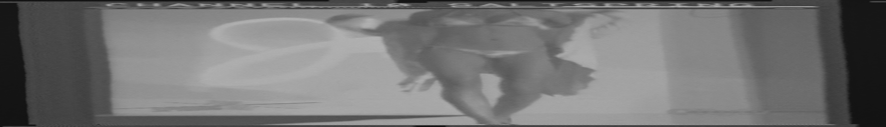

    Here's a field from the first file with:
    RawSource("CBL_Citytv-2007_1.4ta", index="0:409500", width=1820, height=262, pixel_type="Y8")
    [Attachment 39077 - Click to enlarge]
    It looks like all the raw data (vertical/horizontal sync pulses, etc.) is there to work with. Note that one field would really be 262.5 scan lines but RawSource() only allows multiples of 2 when importing Y8 data (it converts to YV12).

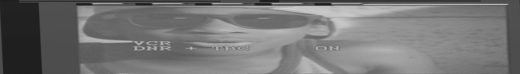

    And one field from one of the videos after a line TBC:
    RawSource("PRE_Home_Alone_MV_1_+TBC.4ta", index="0:383230", width=1820, height=262, pixel_type="Y8")
    [Attachment 39078 - Click to enlarge]
    From this I calculate the line length is about 1820.05 samples.
