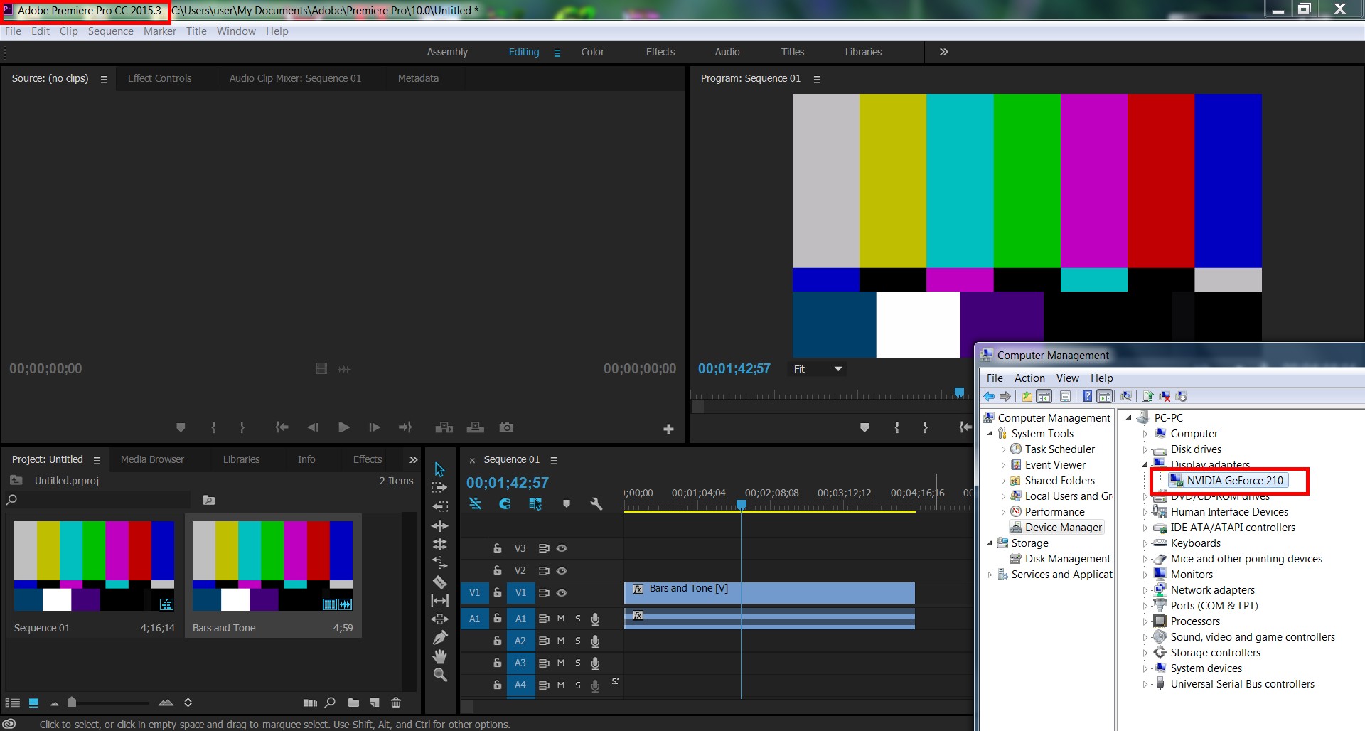

  8. recommended card not necessary to run Adobe Premiere Pro
    for example computer with geforce 210 running Premiere CC 2015:

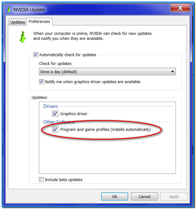

  12. Click image for larger version

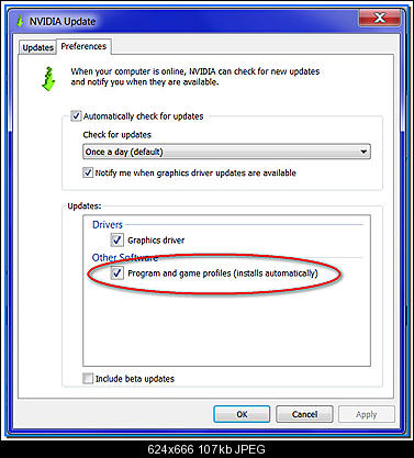

ID:	39133I got notified of an update to NVIDIA. What does program and game profile mean? I do not have games so not familiar with them. It is not any adware is it? Is it possible the driver mentioned would work with Premiere?

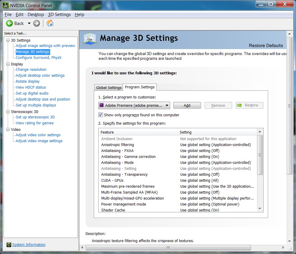

  13. Originally Posted by Sounds View Post
    NVIDIA Control Panel that allows you to override the Optimus application profile setting and choose a particular graphics processor to use:
    did you try uninstall drivers with Display Driver Uninstaller ?
