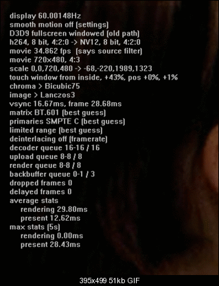

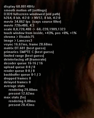

  18. I'm assuming if a Bluray player can play an MP4/MKV via USB it'll play it regardless of the frame rate (up to the maximum it supports). It'll do so even if it can only connect to the TV at 60Hz. I'm assuming a media player built into the TV would play it also, even if it keeps refreshing at 60Hz. I'm assuming pretty much any standalone player capable of connecting to a TV at 1080p and 60Hz would be able to play it without a problem. That's the type of file the OP was asking about. I don't know why you keep referring to playing discs. I've acknowledged you may have format or region issues when it comes to playing PAL discs with an NTSC player.
    Not only will most HD standalone players connect to a TV at 60Hz and play 25fps video, I'd be willing to bet the majority support variable frame rate video, given both MKV and MP4 support it. I haven't tested all the players here but the media player in my TV didn't have a problem playing a VFR MKV when I tested it.
    Can you provide a real world example of an NTSC player that'll play 24fps or 30fps MKVs and MP4s but won't play them if the frame rate is 25fps?

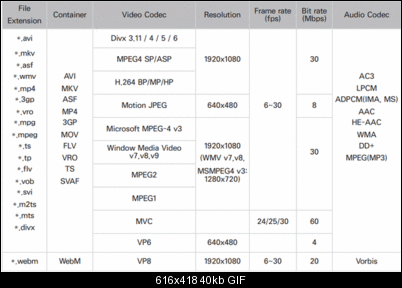

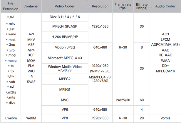

  21. I just got around to putting a few random 25 fps files onto a USB memory stick and then plugging that into the USB port on my Samsung TV set. No media player, other than what is built into the TV. I live in North America. All three files played just fine, although two of them would not play any audio because the "audio codec was not recognized."
    File 1: 1920x1080 16:9 25 fps AVC codec bitrate: variable

  24. Originally Posted by johnmeyer View Post
    I just looked at the documentation for my Samsung TV, and while it obviously is limited to certain codecs (something that is true of any player), and it is also limited to 1920x1080 (it is five years old an not a 4K set), neither the documentation nor my tests show any indication of fps being a limiting factor. Put another way, the TV will play any frame rate without a problem, and certainly plays 25 fps material, even at odd resolutions. It also doesn't seem to care at all about resolution, as long as it is 1920x1080 or lower.
    I'm pretty sure this is true of any other set made in the past five years (or more).
    My Samsung TV is about the same age. The internal manual (under Advanced/Video) for MKV and MP4 says 1920x1080, 6fps-30fps, and 8Mbps for older formats such as Xvid, 25Mbps for h264. From experience it supports High Profile, Level 4.1 with those frame rate and bitrate restrictions.
    Interestingly.... for more traditional file types containing mpeg1 or mpeg2 video (VOB, PS, TS) the manual says it only supports frame rates of 24fps, 25fps and 30fps, but h264 or VC1 in a TS or PS file can be 6fps-30fsp, so maybe usually_quiet could be awarded a couple of mpeg2 points for correctness, even though none of us would encode mpeg2 for anything but DVD compliance anyway.
    mpeg2 is not listed as a supported video type for MKV, and from memory it won't play it, but I'd have to check.
    Not that I'd take the manual as being 100% accurate. It doesn't list AAC as a supported audio type for MKV but it's always played it. For your NTSC TV though, you might find you're restricted to 24fps and 30fps for mpeg2 video even if it doesn't care about frame rates for other codecs. I can't say I've played enough mpeg2 video to know if that's true or that I even care, but anything from 6fps to 30fps should be okay for most video types. I think the Samsung Bluray player here has pretty much the same restrictions while the Sony happily plays higher frame rates and bitrates for full Level 4.1 support (or maybe higher). These days, I think Level 4.2 is becoming the standard supported by 1080p players, if it's not already.
    Like your TV, mine is 5 years old (as are the Bluray players). Newer TVs/players might be less restricted. They might cope with a frame rate as low as 4fps.
    Edit: Here's a manual for NTSC Sumsung TVs. It looks like it'll play 25fps mpeg2 video too.
    http://support-us.samsung.com/nas/storage/201306131733051%5Estorage_attachment%5EF6300...0_e-Manual.pdf
