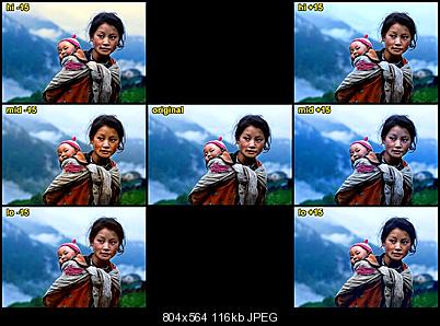

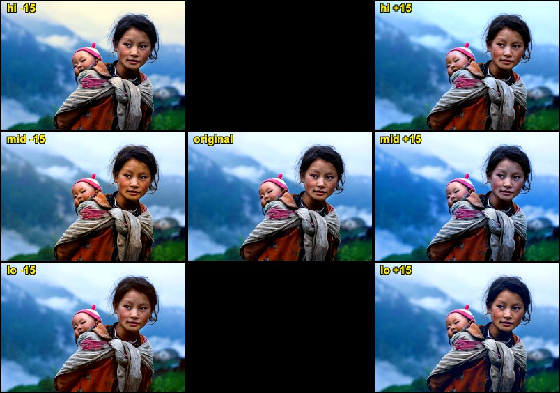

  2. A couple of years ago I posted a script that adjusts color temp separately for lowlights, midrange and highlights.
    Over-adjusted to show the range of the effect. Normally you would use this filter to fix bad white/black/overall color balance.
