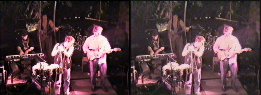

  1. Hello. I'm using After Effects to clean up one of my old band's video. I can correct/clean-up the brightness, color (mostly ), and grain/noise, but really need help on what I can do with the singer and guitar player who are "trapped" under the bright spot lights. I'm using AE CC 2015.3, with Boris CC and Red Giant plugins installed as well. But that's not to say I'm not open to trying other apps...
    I know I'm not going to be able to be able to get their details back, they're washed away with recording of the video. But I'm wondering if a mask or something can be applied to just them or the hot spots to lower the intensity of their "glow". Maybe a motion mask is not the right way (never did a mask on a video), but you can see what I'm thinking.
    I have a 9 second/34mb sample video attached if you wanted to see what the raw video looks like.
    Any help or suggestions would really be appreciated.
    Thanks in advance for any assistance.
    LuLuClip1.avi (sample clip)

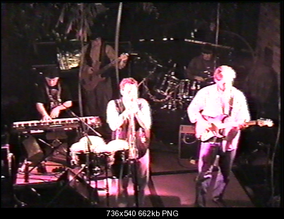

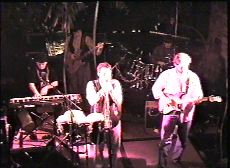

  2. Not only are the whites completely blown out, but the blacks are horribly crushed as well. Both need lots of work and nothing will regain the lost detail. I suggest you go back and recapture it because, almost certainly, the VHS tape isn't like that. Can't you adjust the brightness and contrast before capping? What did you capture with? A Canopus box? In AviSynth-speak:
    Tweak(Bright=16,Cont=0.75,Coring=False)
    ColorYUV(Analyze=True).Limiter(Show="Luma")
