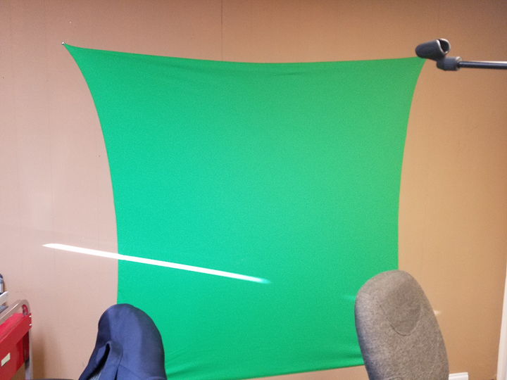

    I am using a Canon Vixia HF R300 and Pinnacle Studio 17. When I use the Chroma Key on a clip I shot, it leaves a black "noise" residual.
    When I use a demo clip, I can remove the green screen completely.
    Here is an example of my issue, I used a basic orange jpeg for the background after I chroma-keyed on my shot. As you can see, even without me and my shadow, there's a continuous black motion haze/noise.
    https://youtu.be/kL2IaQ6BeJ0
    Is it a setting on my camera for light? I have tried with several different lighting fixtures and without any and still have the issue.
    Thanks for all your help.
    Rande

  4. Member Rande's Avatar
    Oct 2016
    HI,
    I think I mis-stated my issue. I use a green polyester screen for the background (actually came with a previous version of Studio). After I used the automatic keyer and it completely removed the green background, I saved it and then added the orange jpeg in Studio timeline underneath the clip.
    Does that make sense Mr. Bean?
Name:	green screen set up.jpg

  6. You didn't upload what the "before" looked like but very likely the other clip was better lit , or maybe synthetic 1 shade of green (it's an animation so I'm guessing it's likely) . Your clip probably has uneven green screen, suboptimal lighting setup
    When you have noise like that on a single color composite, usually it means a bad key - there are leftover semi transparent pixels in the alpha channel because the "green" actually consists of many different shades of green. ie .it's uneven green screen . If you were to look at the alpha channel in your software after keying, it's probably very noisy.
    An "automatic" keyer probably can't handle your video. You either have to improve the setup or use better software or technique. Or if it has more manual controls try fiddling with those. For example, you can improve on it by using a "garbage matte" or mask, to isolate only the closer pixels, discarding the far pixels (they don't even get exposed to the keyer)
    Compression mentioned earlier is also an issue (for example YT re-compresses everything) and partially makes the problem worse, but that's not likely the underlying issue. It only exacerbates the real issue
