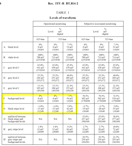

  17. I don't know how to read the digital value of the black stripe level in BT.814-2, do you?
    It says (12)48.
  18. Originally Posted by chris319 View Post
    It says (12)48.
    Sample value 12 for 8 bit and 48 for 8.2 (10 bit where 16 = 64 and 235 = 940 - i.e. normal studio mode).
