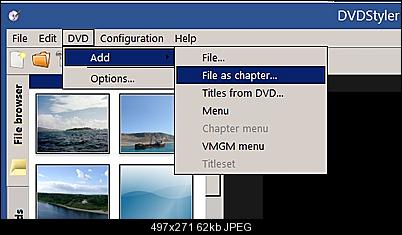

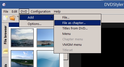

  2. Perhaps try DVDStyler and start by making a DVD folder structure or an ISO for test.
    And maybe watch this
    https://www.youtube.com/watch?v=w0jIx0dukXU

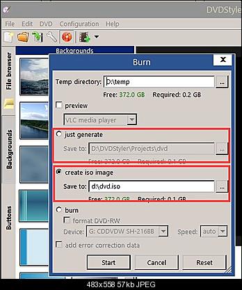

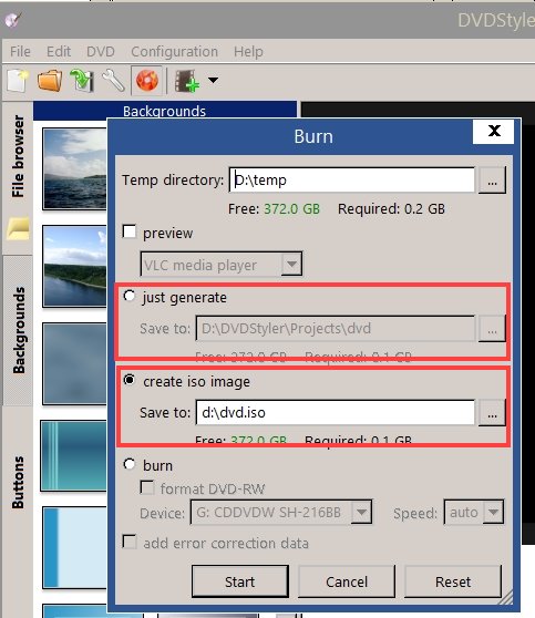

  4. When you hit the burn icon select "just generate" or "create iso image".
    These can be testet in a software player and the physical disc isn't burn until the DVD work as intended.

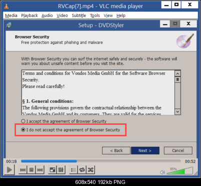

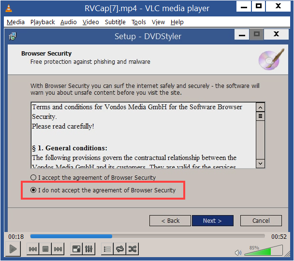

    Almost every comment about DVDStyler refers to a ton of malware that gets installed with this program. Is this true ? It has me worried.
  6. In the current x32 installer version you'll have to deselect "Browser Security".
