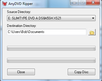

  9. Originally Posted by orsetto View Post
    AnyDVD by itself does not have any ripping features or options
    Yes it does.

  11. Originally Posted by mike20021969 View Post
    Yes it does.
    Your screen cap is from the newest "Red Fox" version of AnyDVD, which isn't in wide use yet for various marketing reasons. My comments refer to the original SlySoft version, which seems limited to straight-across rips with no control over exactly what gets ripped (because they expected you to use CloneDVD for that).

  13. Originally Posted by orsetto View Post
    Apart from Redfox wording, it's identical to the SlySoft version.

  14. Originally Posted by mike20021969 View Post
    Screen capture from 2013:
    My apologies: I couldn't for the life of me locate this specific sub-menu that you screen-capped.
    In my ten years using AnyDVD almost weekly, somehow I've never right-clicked the tray icon to invoke that mini-menu: instead I've always just left-clicked for the complete control window. So you've taught me something new today!
    Now able to answer my own question: the mini-menu "Rip Video To Hard Disk..." option simply brings up the same featureless straight-up rip screen I showed in my earlier post (which I had opened from directly within AnyDVD). It looks like the Red Fox version remains limited to ripping "complete disc as-is": getting rid of disc clutter still requires a secondary utility like DVDshrink or CloneDVD.
