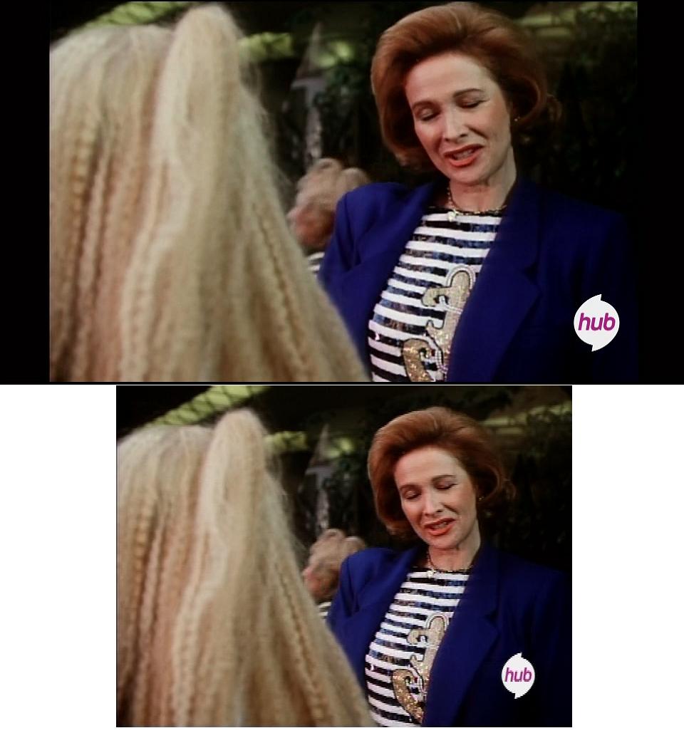

    I don't know whether the new Discovery Family channel does this same nonsense, but here's an obvious example from its previous incarnation The Hub to show how the two feeds differ.
    HD = vertically cropped 14:9; fewer compression artifacts thanks to higher bitrate; poorly deinterlaced (jaggies)
    SD = 4:3; many compression artifacts due to low bitrate (the duplicated lines here were caused by the media player of the person who took the screenshot; the feed itself had no such issue)
    The "Hub" logo bug covers a different portion of the woman's jacket and is pixel-perfect on the HD feed, so the upscaled image could not have been produced by the cable provider from the SD feed. And the SD feed could not have been produced from the HD feed, obviously, unless someone invented a magic "fill in top & bottom" filter.
