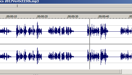

    Here is a picture of the waves before normalization, as recorded
    and also one after normalization which seems much too low. I am making a youtube with slides and video with narration under it. Will this be loud enough?

    The problem is what's called intersample peaks. If your samples are very close to 0 dBFS, they may be rendered higher than zero by a digital-to-analog converter, producing clip distortion. I find that peaking no higher than -1 dBFS is usually fine and there is broad consensus that -3 dBFS is a conservative limit. Where is your audio file headed? In some contexts, such as broadcasting, the average level should be much lower according to loudness regulations.
    EDIT: Now I see you are going to YouTube. If you normalize to -1 dBFS everything will be fine.

  6. You didn't mention what normalization level you used. Your "after" looks pretty weak to me (I assume the second pic is after normalization).
    What is the nature of the transient spike? If it is some sort of pop, clank, or other similar impulse event, you might want to remove it prior to doing normalization. Sound Forge's de-click module might be able to handle it.
    If you want to upload a few seconds of the before, I'd be happy to take a quick look at it and make further suggestions. I too use Sony Vegas, Sound Forge, and also iZotope RX. The latter is quite expensive but is a very professional restoration tool that might be able to do a little more with your file than the Sony products, depending on what other issues you are dealing with.
