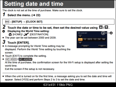

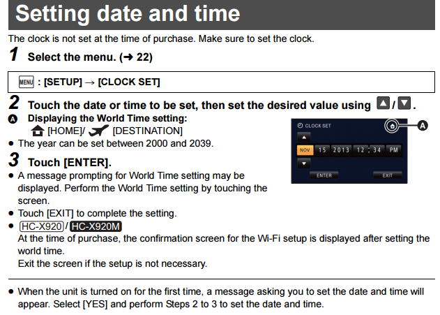

    Here's what I found in the manual. What is wrong or incomplete about these instructions?

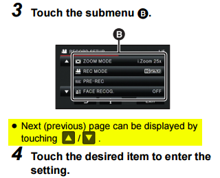

    What I find wrong is that there is no "clock set" option on the camcorder screen. What I get is Menu>setup and then a list of options among which "clock set" does not exist. I have tried for hours to get to "clock set" but have not been able to find it. Could it be that the camcorder should be in "record" mode? (I have tried on "playback" mode). One other thing: the screen as shown in the manual (page 19) does not appear on the camcorder screen.

    After lots of effort, I found that the camcorder must be on "record" mode to set the clock. However, the manual does not specify this in the respective chapter (p. 19). This confirms my judgement of a poor manual for a fine camcorder. It cost me several hours of search and a lot of frustration!
