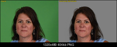

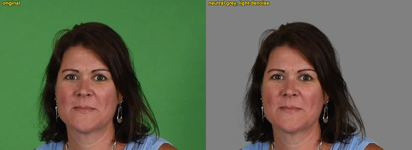

    Here is a 1:1 cropped hair key with 2 layers, and a rough garbage matte. You can get away with just 1 main layer; but the 2nd is to add back a bit of hair detail on the actor's right. It still needs a bit of work (the actor's left shoulder edge is bad, but it's a "hair" key; and the added hair on the actor's right is a bit harsh from the compression, you can see it more in the video), but it's not bad for a quick key given the source footage characteristics.
    Of course proper lighting and recording is the most important, but other techniques you can try that may help are things such as pre screen smoothing, denoising (either pre or post key), levels /contrast adjustments, antialiasing fine hair areas (compression noise and mb edges will cause aliasing and a noisy alpha matte - you can see some of that in the video) . Pros/cons because "overdoing" post manipulations has problems too. Some of the techniques you might use also depend on the specific situation , and specific bg plate you were going to be using (for example you might want to leave some fg noise when compositing on a noisy bg plate), and you can "hide" certain issues from compositing techniques
    Keylight can still produce good results, but it's going to be take more work finessing back and forth with multipass / multiple layers and keys, refine matte, etc..
    preview, video attached below
