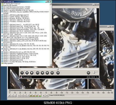

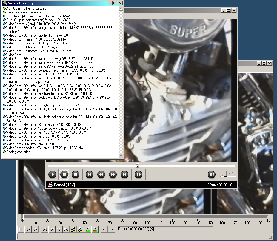

    I enabled x264's logging, opened a video containing YV16 video and put VirtualDub into full processing mode, leaving the input and output colour spaces on auto. Here's the log file. I think I used a resized down version of the "bad" screen shot as the image, which I converted to YV16 and then to AVI. I opened the AVI in VirtualDub and re-encoded it. MPC-HC is displaying the encoded version.
