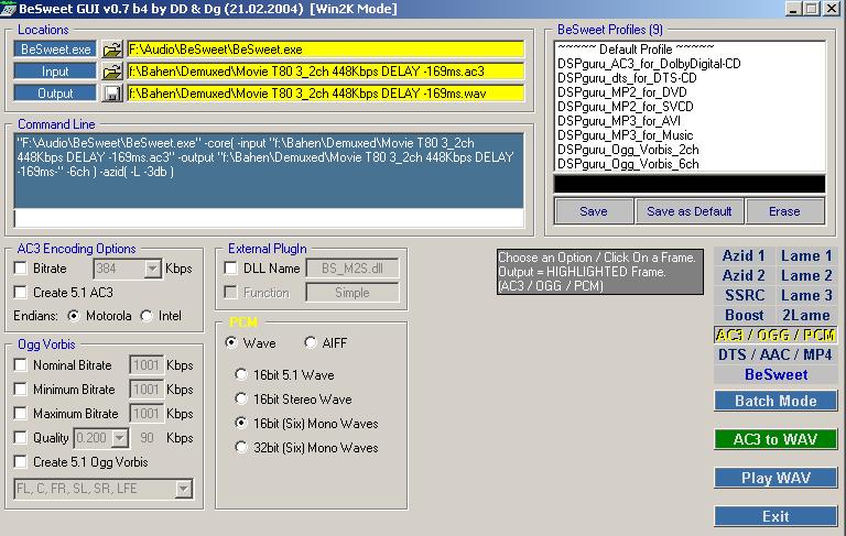

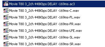

  3. BeSweet and probably other associated programs can do it. It's supposed to be able to handle VOB input but I already had a 6-channel AC3 file handy and used that to test. If necessary, extract the AC3 from the DVD first.

  4. BeeSweet looks like it would be just the thing, if I could just figure out how to use it. I can't get it to show the screen in manano's post. Is there a magic word?
    So you have the GUI? In the picture you can clearly see I'm using the AC3/OGG/PCM section to set it up to decode to six different mono WAV files.

  8. Do you have the BeSweet.exe pointed to, as in my picture? And, yes, after pointing to the Input AC3 file (it'll give a default output name which you can change if you like) and after setting it up for 6 channel decoding in the AC3/OGG/PCM screen, you return to the main BeSweet window and click on "AC3 to WAV" to do the actual decoding.
    Even in the Azid screens I'm pointing to the BeSweet.exe. Maybe you should point it to the Azid.exe instead not really sure. But, as you saw, before replying originally I did a full test to make sure it was working as it should. I'll enclose the Azid.dll, in case you didn't get it. Even if not pointing to it explicitly, it should be in the BeSweet folder.

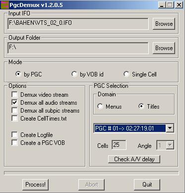

  10. Right, extract the AC3 audio and then open that in BeSweet. To extract the audio there are many ways, once the DVD has been decrypted to the hard drive. I usually get it from DGindex when making the D2V file for use in an AviSynth script. If you don't use AviSynth then get it from PGCDemux. Open the IFO for the movie and choose to demux just the audio track(s):

  11. Thanks again manono but the confusion continues. You say extract the AC3 with DGindex. I can open the ripped DVD with it and it shows the image in the window but what do I do with it? There's an Audio option to decode AC3 to wav but there's no "Go" button. I also opened the DVD in PcgDemux and have it set like in your picture but it gave me a dts file and a two track wav.
