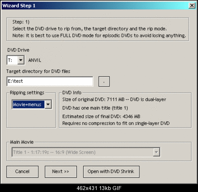

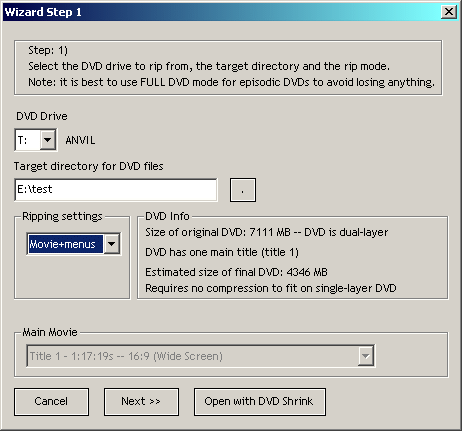

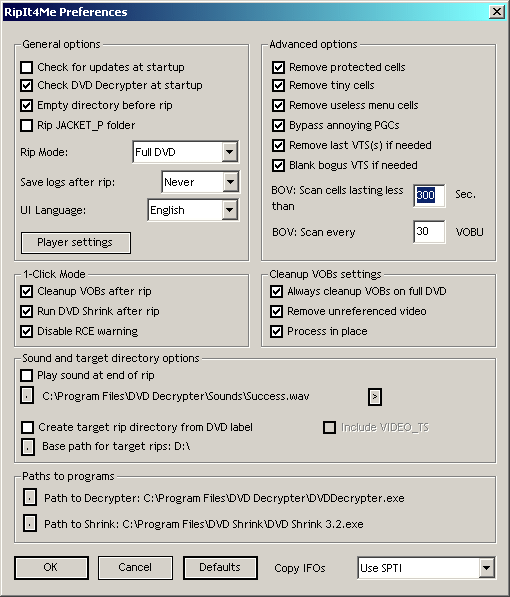

    I'm slow replying but at least you got the movie off the disc. I assume after DVDShrink finished analysing the movie title you backed it up??
    As far as RipIt4Me goes.... after you install it you need to go into it's preferences and tell it where you have DVDShrink and DVDDecrypter installed. There's other preferences you can set also.
    Once that's done click the Wizard Mode button on the main window and you'll see an option to rip the whole disc or just the movie etc. If RipIt4Me doesn't detect any copy protection there'll be a button labelled "Open with DVDShrink" down the bottom and you can open and rip with DVDShrink directly if you want to. That'll open the whole disc as DVDShrink normally does. If there's copy protection the DVDShrink option won't be available, or if you want just the movie and menus click "Next". RipIt4Me will open DVD Decrypter with the required files selected and you can start it ripping.
    When it's done it'll probably offer to open the ripped files with DVDShrink in case you want to shrink them down to fit on a single layer disc. You don't have to. The reason RipIt4Me uses that two step process is because it could update DVD Decrypter's ability to work with newer copy protections. It still can to a point, but unfortunately the studios threatened the creator of RipIt4Me so he stopped updating it a fair while ago. You can still use RipIt4Me with something like AnyDVD running in the background if need be.
    My main reason for suggesting RipIt4Me is it gives you an easy way to rip only the movie without any extras or menus, or to rip just the movie with menus rather than the full disc. If you only need the movie that might do the job. You can rip just the movie with DVD Shrink as I described but you lose the menus.
    Likewise you can open the disc with DVDDecryter and manually select and rip the contents one file at a time if you want to, as that way you'll know which files can be read and which can't.
    PS If you do rip with DVDShrink make sure it's compression is disabled or the output file size in it's preferences is set to something huge so it won't try to "shrink" as it rips. By default it tries to shrink everything to fit on a single layer blank disc. Unless of course that's what you want it to do...
