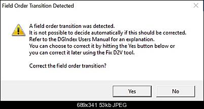

  1. how do i deal with it? Click image for larger version

    well whats causing it ? as for now its the only one it appeared in ...
    i want to use the d2v file for encoding with Megui .
    what will happen if i press yes? or just use the d2v file that was created? some thing will go wrong?
  4. Usually you hit 'Yes' and get on with it.
    It's caused by an ... illegal field order transition. Usually where a 0 goes to a 2 or vice-versa. It's explained in the DGIndex Manual (which you could have checked yourself):
    Fix D2V
    Sometimes streams are encountered that contain mixtures of TFF and BFF material. In MPEG2, these field order transitions are fixed at display time via the TFF/RFF flags. But we usually want to output a stream with one consistent field order, and some tools, such as Telecide and (Leak)KernelDeint, require a fixed field order. Indeed, AVI does not carry a field order property!
  5. Originally Posted by manono View Post
    Fix D2V
    so just click yes and use the d2v file as usual ?
  6. Originally Posted by zanzar View Post
