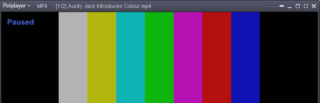

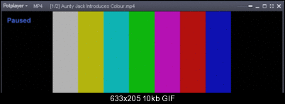

    Start with the built in Colorbars script. Open any video and make sure the "use AVIsynth Filters" and "Add Potplayer Source" options are checked. Click Apply. That's as simple as an Avisynth script gets. If you don't see Colorbars instead of the video, Avisynth isn't working.

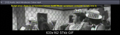

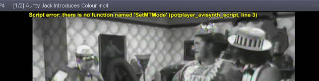

    Next try the Fastest TrueMotion script. That takes me straight into error message territory, as I have the single threaded version of Avisynth installed and the script includes multi threaded stuff, but at least you can see Avisynth is functioning and you're heading in the right direction. Your script doesn't require a multi threaded version of Avisynth, but any additional complaining from Avisynth along the lines of "there's no such function as" would likely indicate there's a missing or non-functioning plug-in. Although in my case it's even more likely to indicate there's typos in the script.

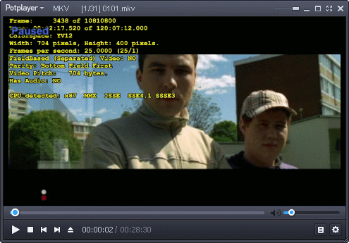

    It might also pay to add Info() to the end of the script you're using to help determine if it's working, as that'll get Avisynth to display some info about the video. Once it's working you can remove it. Or even adding GreyScale() to the end would help determine if the script is being used, because it should output the video in black and white. If the other filtering is quite slow, there mightn't be an immediate display of information or lack of colour etc. You might have to let the video run for a few seconds. Or try typing Info() into the script section without anything else for testing.
