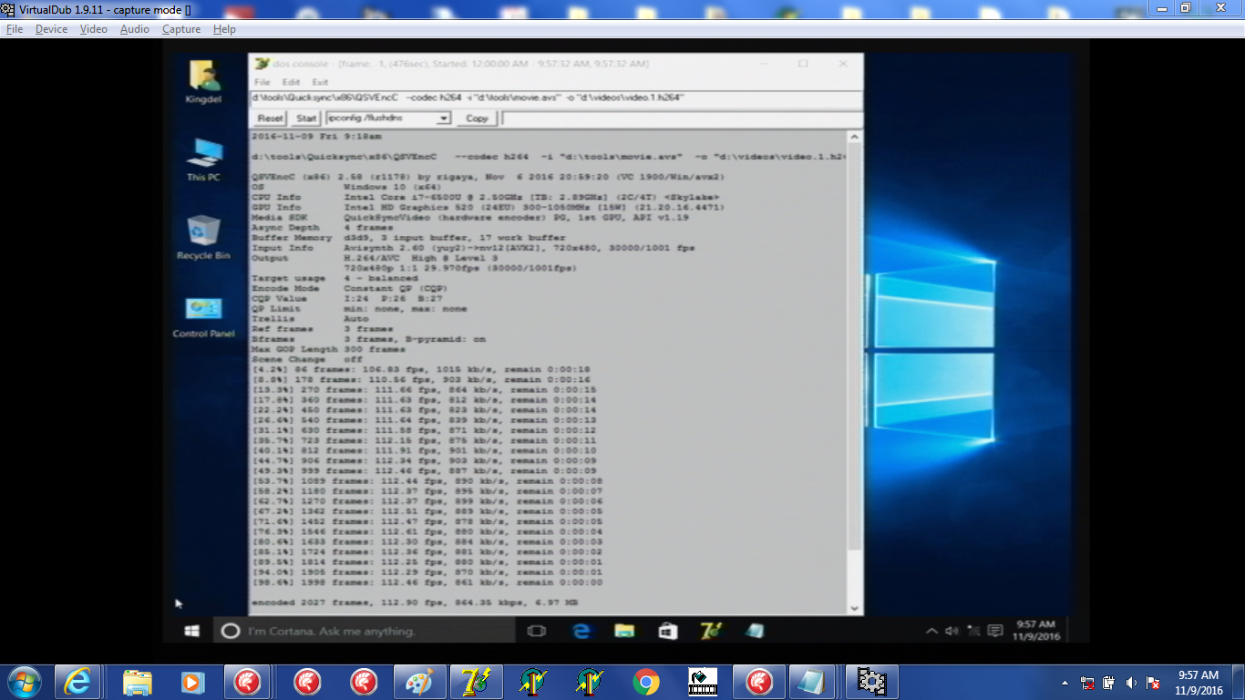

	update.. Just wanted to say that I received my new Kingdel mini pc system. No monitor, I seem to have misplaced my 23" one. So I am searching for a new one to purchase. In the mean time, to be able to test (and play) with this one, I have conjured up a crude yet effective alternative for now:
 Kingdel [hdmi]-to-HDMI2SIDEO-to-ATI600 [svideo]-to-Dell_laptop via virtualdub
 Unbelievable, (and tad bit blurry) but works. I can see the windows 10 pro computer screen, mouse, etc.. What I did was: uncheck "show information panel" and uncheck "show statusbar" and then selected "stretch to window" all in virtualdub.
