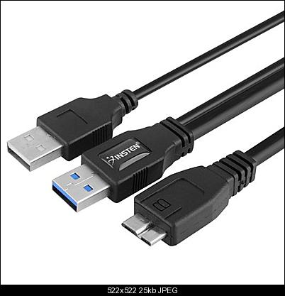

    There one last thing that could (and should) be tried.
    Get a dual head USB cable as shown below. This will ensure you're getting enough power to your drive.
    If you currently have one, get another since cables go bad.
    If possible, plug the USB 3.0 connector (the one with the blue line) into a USB 3.0 port. The other connector can go to a regular USB 2.0 port. As Nelson37 and I have stated, USB 3.0 provides higher voltage and amperage than USB 2.0. This is especially important for portable HDDs which receive their power through USB only.
    My final advice to everyone (after having gone through dozens of external drives) is don't buy an external drive. Instead buy a good external case and put an internal drive into it. This way, if the drive starts giving problems, you can easily extract the drive and test it directly (though a SATA cable and power connector) or through another USB interface.
    Yes, external drives are generally cheaper than their internal counterpart, but the trade-off is that most of the external cases (especially portables) offer poor cooling and protection against shock (especially movement while the drive is running) which are two of the main causes of HDD failure.
