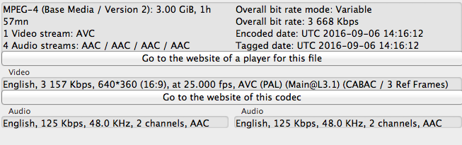

    Here are the details from Media Info

  6. Assuming you're going to make a PAL DVD: The video has to be scaled up to 720x576 and flagged 16:9 to keep the correct aspect ratio. Then, since the video is only 57 minutes, encode it MPEG 2 at ~9000 kbps VBR and the audio at 256 kbps (or higher) AC3.

    I read that as 1h 57mn, so 117 minutes. Then a mere 4800 kbps video with one audio track at 224 kbps would fill a DVD-5 disc. A DVD-9 disc would accommodate a more generous bitrate and/or more audio tracks.
    Will you be needing to keep all 4 audio streams that Media Info reports?
