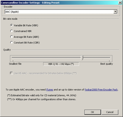

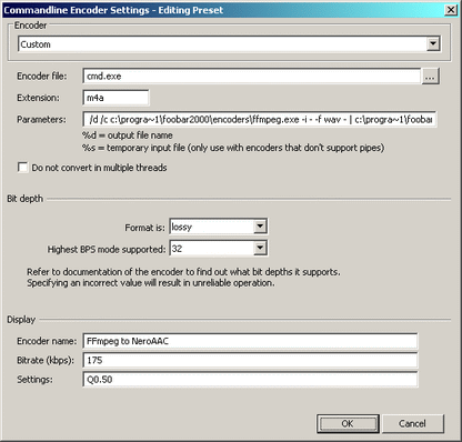

    I wrote a bit of an essay here a while back. It should help you find the various AAC encoders and/or the files they depend on. https://forum.videohelp.com/threads/370412-Looking-for-an-AAC-LC-encoder-from-Frauenhof...=1#post2376348
    I tend to use QAAC mostly these days. Partly because it has a --no-delay option that gets it to remove any encoder "padding" from the beginning (extra silence). All lossy encoders add it. For AAC tends to be around 50ms. MKVToolNix compensates for the padding when muxing audio but I don't think any other muxing programs do. QAAC is also the only AAC encoder with the ability to peak normalise. It has an option -N that can be added to the command line to enable it.
    I mentioned foorbar2000 in the post I linked to as I mostly use it for audio encoding. It can encode multiple files at the same time, it comes with conversion presets for all the AAC encoders or you can create your own, there's DSP plugins for decoding DTS and AC3, it has a built in ReplayGain scanner which can be used to normalise audio (better than peak normalising, in my opinion) there's a third party matrix mixer that can be used for downmixing (DSPs can be added to the conversion chain), and the whole setup can be saved as conversion presets. The easiest way to set up an encoder configuration in foobar2000 is to select an appropriate encoder preset, adjust it to your liking, and from there if you switch to "custom" foobar2000 will fill in the command line for you, which you can then alter manually if you want to.
    And not that there's really much need, because foobar2000 supports any command line encoder, but for fun I tried creating an encoder preset to encode with ffmpeg piping the audio to NeroAAC. I had to mess around for a while to find the magic command line, but it works. Just for fun. Or you could add the ffmpeg options to the comman line pandy suggested.
    " /d /c c:\progra~1\foobar2000\encoders\ffmpeg.exe -i - -f wav - | c:\progra~1\foobar2000\encoders\neroAacEnc.exe -q 0.5 -ignorelength -if - -of %d"
    Another GUI you might want to try is AnotherGUI. I mainly use it with ffmpeg myself but it should support any command line encoder. You can create presets and then batch convert by dragging and dropping files onto the GUI.
    PS. Sorry if you see the images twice. It's a forum issue, not me causing it.

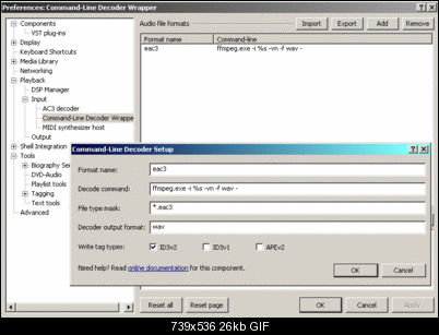

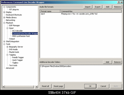

    And if that's not fun enough, any installed DirectShow codec can be used for decoding. For some reason I can't find a trustworthy looking link for that one at the moment, so I've attached it for you (see the end of this post). If you have something like ffdshow or LAV Filters installed, you can use them to decode any format they support.

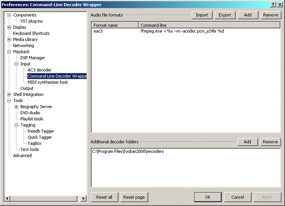

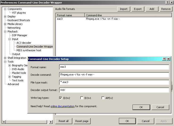

    Oh.... and if there's a command line decoder, foobar2000 can use it, although it's not as much fun.
    http://www.foobar2000.org/components/view/foo_input_exe
    I say it's "not as much fun" because either foobar2000 can't seek, or it can but it's got to parse the entire file fist which makes opening files slow. There's no DSP for decoding EAC3 for foobar2000 (not AC3, there's one for that) so I use the command line decoder wrapper and ffmpeg. The following command line allows you to seek once a file is opened, but opening it can take a while.
    ffmpeg.exe -i %s -vn -acodec pcm_s24le %d
    This command line will open the audio straight away, but not allow you to seek. You can still convert though:
    ffmpeg.exe -i %s -vn -f wav -

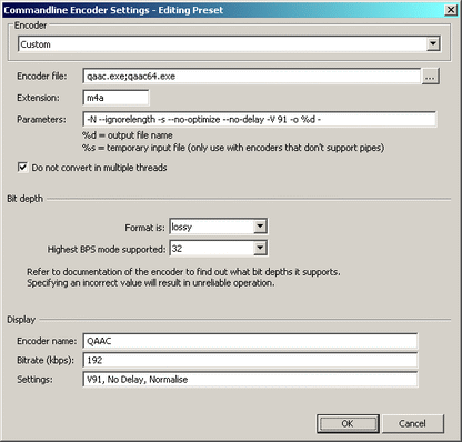

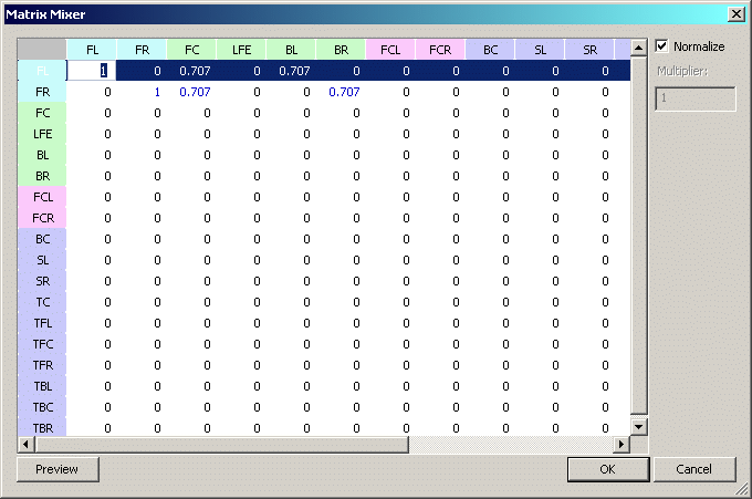

  15. Once you've got QAAC working, it should normalise, but I'd generally not use peak normalisation myself, although if I'm downmixing to stereo I sometimes do. I downmix with the Matrix Mixer DSP. http://skipyrich.com/w/index.php/Foobar2000:Matrix_Mixer
    It has a normalise function which automatically reduces the volume enough to prevent clipping according to how you combine the channels. That often leaves the audio a bit quiet, so then I use QAAC's normalising option to peak normalise as it's encoded.
    My 5.1ch to stereo matrix, but you're free to downmix however you prefer.:
    [Attachment 38901 - Click to enlarge]
    You can scan any file with the ReplayGain scanner, then save the ReplayGain info to tags. There's a way to use that info when converting to peak normalise, but it's still not the best way. Normally you'd use ReplayGain to normalise to a specific volume. I can explain how to apply ReplayGain to the conversion chain if you're interested.

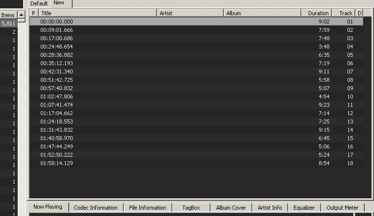

    For audio inside MKVs, I find it's often better to extract it and then convert.... for this reason only:
    [Attachment 38902 - Click to enlarge]
    Foobar2000 splits the MKVs into individual chapters in a playlist (assuming it has chapters. You can create a conversion preset which converts them as a single file, but I prefer to extract the audio and work with it directly. gMKVExtractGUI and MKVCleaver can extract the audio from MKVs (the latter is better for batch extraction). Both require MKVToolNix to do the actual extracting.
    One last tip..... when I create a QAAC encoder preset for normalising, I tick the "do not convert in multiple threads" option. That's because in order to normalise, QAAC has to process the entire file before it encodes, which is fairly fast.... like decoding to a wave file.... and processing more than one file at a time can keep your hard drive busy. See how you go, but the option is there. For converting without normalising I don't check that option and let foobar2000 convert multiple files at a time.

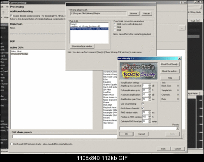

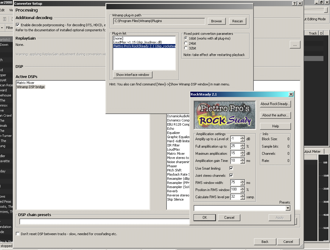

  21. It sounds like what you need is some compression (levelling out the dynamic range so the difference between the quiet bits and the loud parts are reduced).
    You can do it when encoding the audio, but personally I wouldn't. I prefer to compress it on playback as if you encode it that way there's no going back. Most TVs have some sort of "night mode". Some software players do also. Software player normalisation doesn't seem to be anything too flash, although Potplayer lets you use WinAmp DSPs and there's a couple of good compressors. I use one myself, but I load it into ffdshow and run it that way as I prefer to use MPC-HC as a player.
    And as you might imagine, there's a WinAmp Bridge DSP plugin for foobar2000, so you can run WinAmp DSPs and add them to the conversion chain. If I was to do that, I use the same DSP I normally use on playback. I haven't found anything a like more.
    http://winampheritage.com/plugin/rocksteady-2-1/1099
    Or this one's quite good, and simple to use.
    http://loudmax.blogspot.com.au/2014/11/loudmax-plugin-v115-released.html
    The Winamp Bridge works, or you can load the VST version with the help of the VST Adaptor for foobar2000.
    http://wiki.hydrogenaud.io/index.php?title=Foobar2000:Components/VST_adapter
    There's advice on how to stop the WinAmp Bridge crashing on this page, but ignore it. The current version is fine:

    To get you started if you're interested:
    The WinAmp Bridge added the the processing section of a converter setup. It's configuration window is open. In turn it's opened the RockSteady plugin to the settings I use for playback. You don't need to install WinAmp to use the plugins, although I think RockSteady only supports stereo.... now I think about it. LoudMax might support multichannel, if you're into that sort of thing. I'm definitely not, so stereo is fine for me.
    Link to the screenshot in case the attached pic doesn't display.
    https://forum.videohelp.com/attachment.php?attachmentid=38910&d=1476562754
    For the record, those compressors actually work by making the soft bits louder, so then you can turn the over-all volume down. That's generally more effective than compressing the loud parts to make them quieter as the latter tends to require constant adjustment.
    PS If you ever decide to use foobar2000 as an audio player, sticking this DSP in the playback chain is quite subtle, but quite effective. It gives the high frequencies a bit more life without sounding like you've boosted them with an EQ.
    Noise Sharpening (foo_dsp_delta)
  22. There is another plugin for foobar2000 that will reduce dynamic range and normalize audio - EBU R128 normalizer. It doesn't have any settings. You just put in DSP chain and start conversion.
  23. The EBU R128 Normalizer works quite well, but I'll climb out on a limb and declare my RockSteady settings do a slightly better job. The EBU R128 Normalizer must use a larger "window" for determining the volume, so sometimes when the audio goes from soft to loud in an instant, it doesn't "react" fast enough... for want of a better description.
    ffmpeg generally comes equipped with the Dynamic Audio Normaliser command line utility (pandy offered a suggesting that included it earlier). It has much the same settings as RockSteady and should be able to produce a very similar result. Or there's a VST version you can load into foobar2000, but I don't think it has a GUI yet so I'm not sure how you'd go about configuring it.
    I uploaded the attached samples quite a while ago in another thread, but here they are again.
    1. Downmixed to stereo, no compression.
    2. Compressed with RockSteady
    3. Compressed with LoudMax. It's not as good as I expected but I just threw that one in. It's probably too compressed. I haven't played with LoudMax much.
    4. Compressed with foobar2000's EBU R128 Normalizer DSP.
    The LoudMax compressor seemed to do a little better in respect to "pumping" or a lack thereof. The first second or two is just background noise. RockSteady and EBU R128 increased it for a "pumping" effect, but LoudMax didn't, or nowhere near as much. Interesting.....
    Mind you my TVs night mode isn't great in that respect. I can often hear background noises increasing and decreasing in volume. Nobody else in the house seems to notice though, or care.
    The best method I could come up with to make the compression comparisons fair was to feed each DSP the same downmixed audio and let it do it's thing while I converted to wave, then I scanned those with ReplayGain and adjusted them all to 89dB as I converted them to AAC. Except for the EBU R128 Normalizer sample. It normalizes to 89dB as it compresses so there should be no need to adjust the volume later.
    Have a listen to the volume of first gunshots at roughly the 1 minute 5 second point and compare them to the original. For RockSteady, their volume is pretty much the same (but the quiet parts are louder). The Loudmax DSP probably squished them too much, and for the EBU R128 Normalizer version, I think the first couple of gunshots actually increased in volume compared to the other samples
    After normalising to 89db and scanning (4x over-sampling), the loudest peak for each sample is....
    Original: -2.92dB
    RockSteady: -3.79dB
    LoadMax: -9.64dB
    EBU R128 Normalizer DSP: +0.05dB
    The deviation from the target volume of 89dB (ie Track Gain)
    Original: +0.02dB
    RockSteady: +0.02dB
    LoadMax: +0.02dB
    EBU R128 Normalizer: +0.21dB
    Mind you I'm not advocating applying compression while re-encoding. It's better to apply it on playback if possible. And the RockSteady DSP doesn't handle multi channel audio (I don't think) but I'll resist a rant about surround sound sucking and blowing at the same time and just say that doesn't bother me, because I always downmix to stereo on playback anyway.

    1. Can I get a better quality than this command line? Or this the best possible quality in Qaac?
    ffmpeg -i "input.mka" -f wav - | qaac64 -i -V 127 - -o output.m4a
    (I had to install iTunes to make this command line work.)
    2. Also, what does -N (normalisation) actually do? Whenever I play it on TV, the volume suddenly increases and decreases. Does normalise fix that problem or does it do something else? This is not highly necessary as PotPlayer has an inbulit feature named "Normalize" which fixes the sudden changes in volume.

    Originally Posted by knightplex View Post
    I used foobar but it has no decoder for TrueHD files, and also I'm comfortable with command line. So I started using Qaac command line and it's working.
    You can decode any format with any command line decoder with the help of the Command Line Decoder Wrapper DSP, so if ffmpeg will decode it:
    It's not ideal for day to day playback because you either need to use a command line that decodes to a temporary file so foobar2000 can navigate and display the correct duration etc, or use a command line such as the one above in which case you can't navigate, only decode from start to finish.
    As I only use the Command Line Decoder Wrapper DSP for converting eac3 files to another format I go with method B. The conversion process works normally and there's no waiting for temporary files to be created. That gets tedious quite quickly.
    Another option is to create a script and open the files via Avisynth and the AVS Input DSP. Once the script is open foobar2000 should behave as though it opened the source file directly.
    Option number three might be to decode via DirectShow with the help of the DirectShow Input DSP. I haven't played with it a lot but I think the idea is to specify a supported file type for DirectShow Input in preferences and any audio for that file type would be decoded via DirectShow. I've been meaning to test it in preference to using the command line decoder if possible. Now you've reminded me......
    For some reason the DirectShow Input DSP can be a bit hard to find and I can't be bothered looking for it at the moment, so I've attached it to the end of this post for you.
    As suggested by _Al_, decoding with eac3to is another option. You can even configure foobar2000 to decode with it via the Command Line Decoder Wrapper DSP.
    You can install it but you don't have to. The makeportable.zip file here contains a file for extracting the required files from the itunes or quicktime installers to a folder labelled QTFiles, which you just put in the same location as QAAC.
    It peak normalises. ie works out the loudest peak and adjusts the volume of the entire file by the same amount so the peak is at 0dB. QAAC needs to create a temporary input file to do it which is why it's slower than without normalising. If I'm encoding multichannel to multichannel (no downmixing) I just leave the volume as is and don't use peak normalising.
