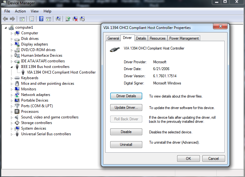

  14. aBigMeanie aedipuss's Avatar
    Oct 2005
    666th portal
    this is the driver that works for me. never had a problem or had to change it. ports are built into the motherboard.
