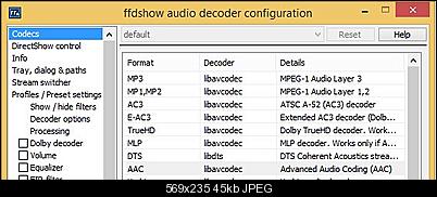

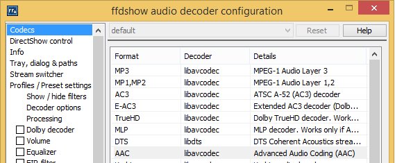

  9. FFdshow is installed and set up as in that screenshot. Is there a different script I should be using for that?
    It was working fine, I installed LAV, it crashed every time I tried anything that had worked before, I uninstalled LAV, it worked fine again.
