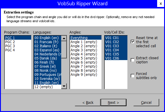

  5. Try using VsRip for ripping the subtitles. It'll let you choose between the PGCs
Name:	Screenshot - 10_5_2016 , 1_14_26 PM.png

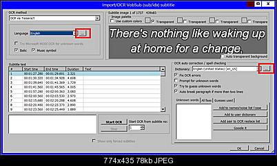

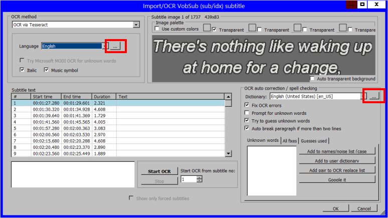

    I would use Subtitle Edit (install french Tesseract + Dictionary - use the three dots) and make OCR.
    SE has Google translate that may give you 1/3 usable english subtitles. (Hard) work for the rest and you can use "File -> Export -> Vobsub."
    If you want to follow the guides and use Muxman you can convert the idx/vobsub to sup with BDSup2Sub.
