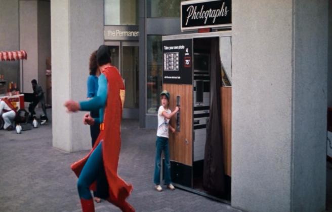

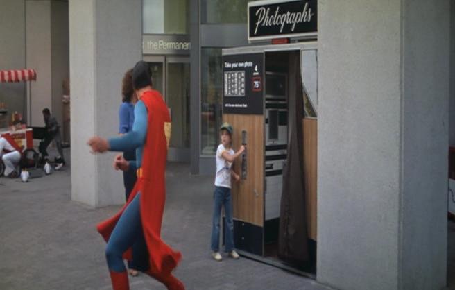

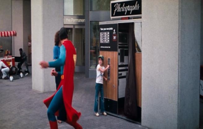

    I started by cropping away black borders of the DVD frame, cropping away additional picture around the HD frame, resizing to the same size (though that wasn't actually necessary I did it so I could easily Interleave() the videos for later analysis), and converting the bd video from rec.709 to rec.601. Then built the histograms and applied ColourLike(). But ColourLike() still didn't work well.
    I'm pretty sure they adjusted colors of different objects differently. For example, they probably built a mask from the red cape (via the hue) then applied a specific transformation just for that. And applied a different transformation for the blue suit, etc. So you'd have to reverse the process for those specially treated object. AviSynth isn't the right tool for this type of work but here's a crude example. After cropping, resizing, and rec.709 to rec.601 color conversion:
    DVD frame:
    [Attachment 38815 - Click to enlarge]
    BD frame:
    [Attachment 38816 - Click to enlarge]
    BD frame, only the red cape adjusted (and a few other red objects):
    [Attachment 38817 - Click to enlarge]
    The code:
    redmask = bdcolor.MaskHS(StartHue=95, EndHue=105, MinSat=30, MaxSat=150).BilinearResize(bdcolor.width, bdcolor.height)
    bdcolor = Overlay(bdcolor, bdcolor.Tweak(hue=-10, sat=0.8, cont=1.5), mask=redmask)

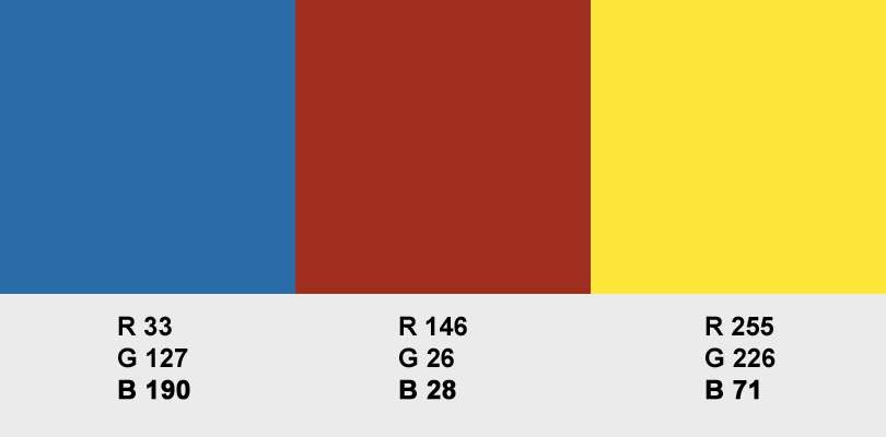

    May 2014
    Memphis TN, US
    As near as I can gather from official Superman sites and color sites, these are the RGB values for Superman's suit, listed as "Superman Blue", "Superman Red", and "Superman Yellow", none posted together but found separately on different websites:
    The official Superman logo is posted on several sites:
    Note on the logo that blue and yellow are about the same as the palette, but the brightest red in the center is
    R 230
    G 0
    B 71
    on every post I was able to copy, and darker at the edges (reduced red).
    Ambient light, highlights, shadow, etc., will affect the exact hue. Copy these Use these as a guide. Colors might display differently in your browser. Colorists woulkd use pixel samplers to check color matches. Most advanced NLE's and color apps will have pixel samplers and other aids. What you do with skin color and other objects is up to you.
Name:	superman palette.png
