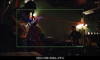

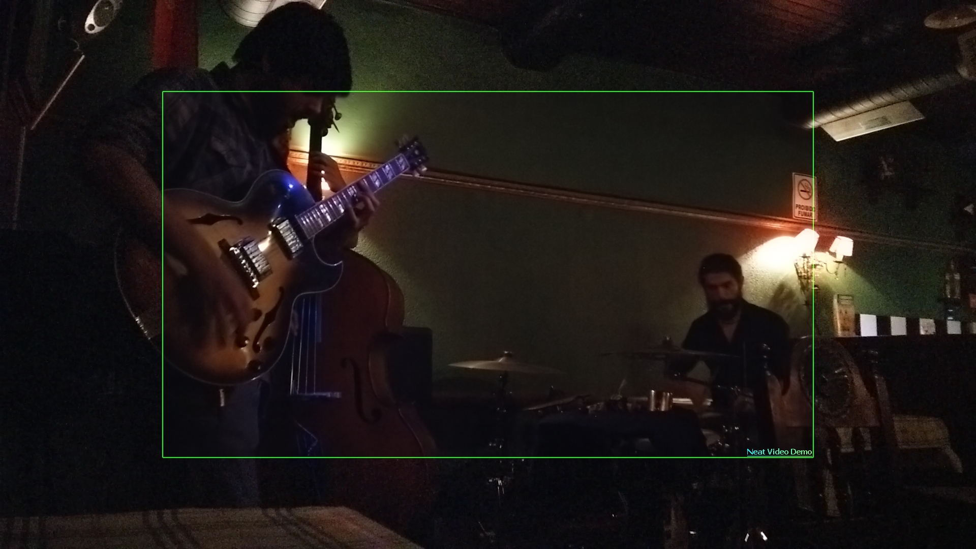

    Thanks jagabo, read a lot of your old comments here about similar problems, meanwhile i tried neat video demo with virtualdub and i was amazed at the results...will try your advice, thanks

  4. If trained properly and not overused Neat Video can work well.
    Attached is a video from the above TemporalDegrain script. You can play around with weaker or stronger settings to get what you want. Watch for things like disappearing wood grain on the guitar, texture on the walls.
