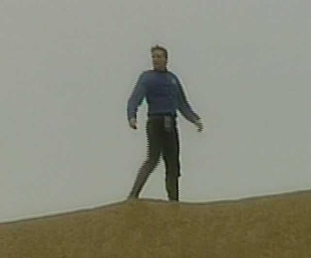

I recently starting ripping DVD's, at the moment I'm working on an old PAL DVD.
But I've noticed a problem, I'm seeing these kind of horizontal lines when there's movement on the screen, really obvious if you pause it.

	Sorry, I've had no luck using either of those programs.
 But here's a screenshot if that helps.
 https://forum.videohelp.com/images/imgfiles/BgCUyY5.jpg
	Not good enough. You opened a VOB in DGIndex and used the [ and ] buttons to isolate a small section (after using the slider to get to the section you want)? If so, what's the problem? You'll have to do better than 'no luck'.
 Not a bit. It's already been deduced that what you described is interlacing, but it's important to know what's causing it. Then we'll know how to treat it. I am surprised, though, that Handbrake couldn't deinterlace it.But here's a screenshot if that helps.

	The frames are interlaced, top field first, but it's encoded progressive. AssumeTFF().QTGMC() will give you smooth 50 fps video.
	I find it hard to believe that a Red Dwarf DVD would have been incorrectly encoded progressive.
	In future if you see such pattern then you can use some deinterlacer (yadif or similar) - your source is interlace and your display is progressive - on display that is or interlaced or process incoming video trough deinterlacer such pattern as you describe will be not visible.
