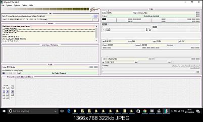

  5. Click image for larger version
Name:	gspot screenprint.jpg
ID:	38764 This is a screenprint of the results in GSpot if this reveals anything useful?

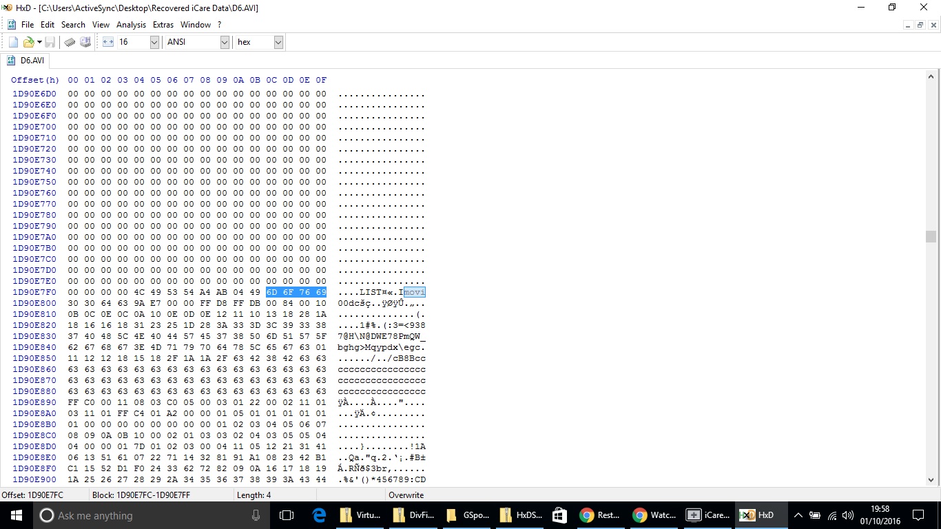

    I've opened the good file and located movi and the string LIST just prior to it. (Screenshot attached).
    Is it just a case of copying everything before the "L" into the bad file?

  8. Originally Posted by ReggieB View Post
    Yes. But that's just the start. In my experience with undeleted files, if the header is bad the rest of the file is likely to be bad too.
    Yes, but first repeat the search in the bad file to identify its header, which is the only part of that file you will replace.
    It depends on the capabilities of your AVI recovery software. Some programs will scan for chunks and fix up the size values, while others will simply choke. In the latter case, it's necessary to identify and count byte ranges, then replace size bytes with the correct values, respecting little-endian byte ordering.
  10. Ok so I've transplanted the header into the bad file, and tried to open in VirtualDub to repair it, however I get the error "Invalid AVI file: The main 'movi' block is missing". When I open in DivFix it returns the error "I/O error 131".
    Like you say, maybe this is just the beginning! Still staying positive tho!
    Aug 2010
    San Francisco, California
    Does your bad file even have a movi chunk? If not, then you are probably out luck unless you can find a good heuristic program to work on it. Otherwise, the problem is likely to be incorrect chunk size values as I explained above.
  12. I've looked at the bad file and you are right there is no movi chunk. Not looking good for this file! I've looked at another and there appears to be a movi chunk but it is located halfway through the file and there is no header (screenshot attached). Is there hope for this file? Looks like it may be jumbled.
