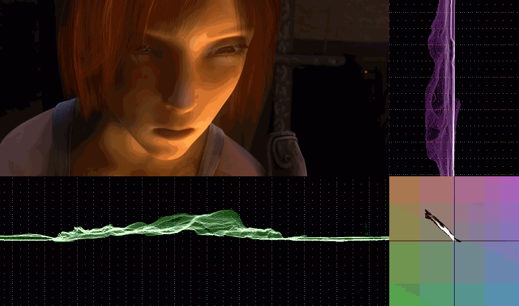

    I first noticed the slight change of color when viewing the videos. Then I checked with the VideoScope filter in AviSynth. With two videos interleaved you can A/B switch individual frames with an editor and it's easy to see the problem.
    [Attachment 38813 - Click to enlarge]
    Ignore the posterization and poor image quality from conversion to GIF. But note the way the U and V channels bounce up and down (for the U channel on the top right "up" is to the right, "down" is to the left). That's alternating between a frame of the source and the same frame from the optimized encoding.

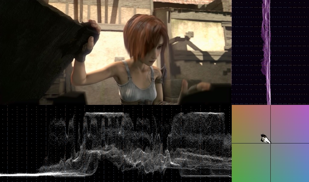

    1. As to grey levels, we do indeed clip the lower range to 16, and the upper to 240.
    You may be implicitly doing that somewhere in your code but the samples I sent you for processing came back with blacks mostly clipped at Y=20 with a few overshoots below that. Ie, big black areas of Y=16 came back at Y=20. From a video encoded by your web site (job 37, if you want to verify it yourself):
    unprocessed:
    [Attachment 38864 - Click to enlarge]
    processed:
    [Attachment 38865 - Click to enlarge]
    Those were created by VideoScope() in AviSynth. On the bottom is a waveform graph of the luma channel. On the top right is a vertical waveform graph of the U channel (the V channel has the same -1 drop). On the bottom right is the UV vector plot.
