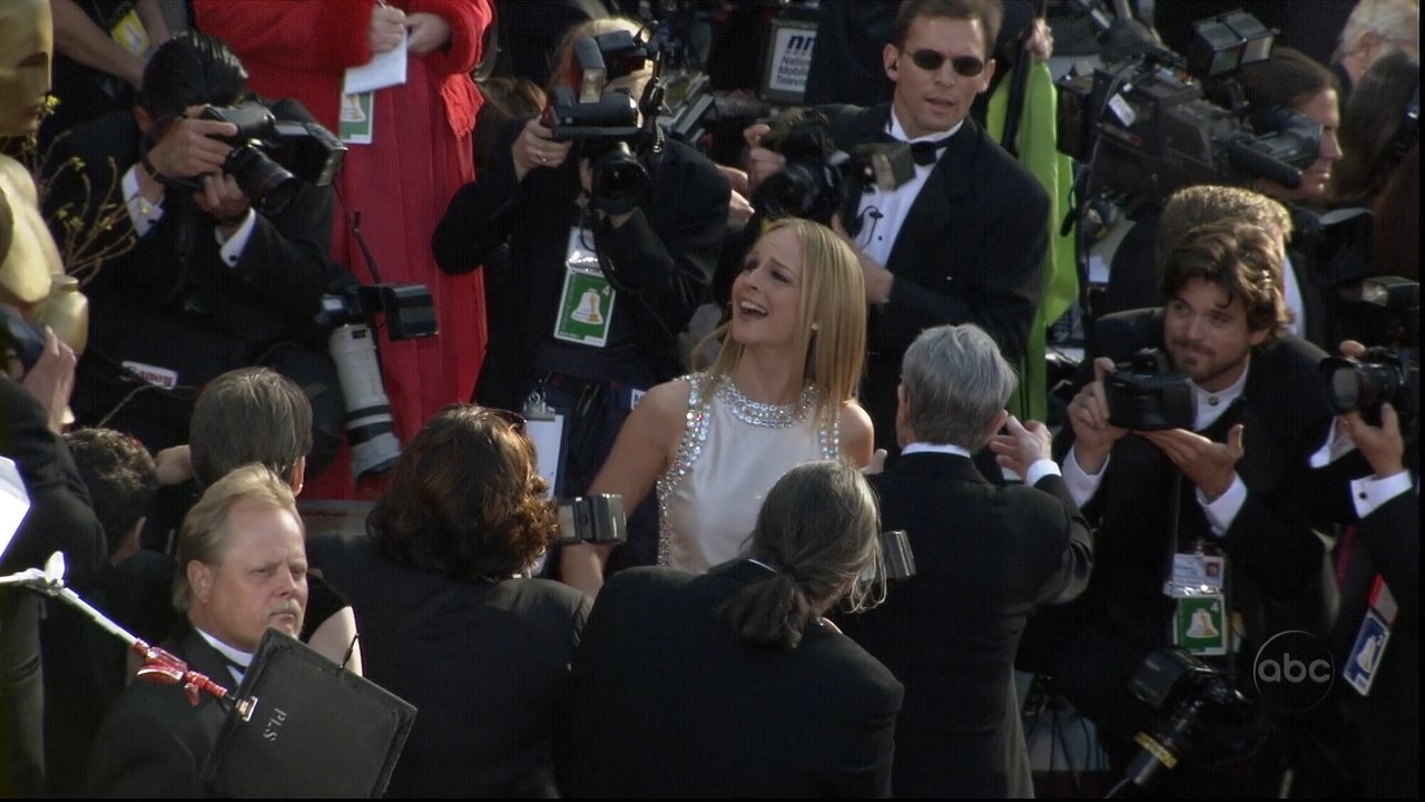

    The ABC clip on the demo page has some sort of ugly crosshatching artifact throughout (both unfiltered and filtered).

    vaporeon800, I don't know to which video you refer, nor at what resolution you are playing it. But I can say that the videos are sourced from the Xiph Derf site without change, and so if the source contains artifacts, we should correctly reproduce them! However, if there is a problem with the compression process, I'd love to know more!

  23. Formerly 'vaporeon800' Brad's Avatar
    Apr 2001
    Vancouver, Canada
    The only one that is downloadable on the demo page, unless I'm missing something. "ABC clip" = 720p60 red carpet footage with ABC bug in corner.
    I don't see this one on their site, but I agree regarding the artifacts. I just think it would make more sense to add a video demo that isn't flawed to start with, such as one of the Xiph sequences you quote the numbers from.

  24. Member
    Sep 2016
    Thanks, vaperon, for your comment. I will point out that some of the Derf video suffer from the same problem, especially the controlled burn video. All of the Derf videos have been rendered and are available for review at www <dot> zpeg <dot> com <slash> netflix <dot> shtml. These videos are mastered at Neflix rates. Perhaps I will add links to these files into the demo page...

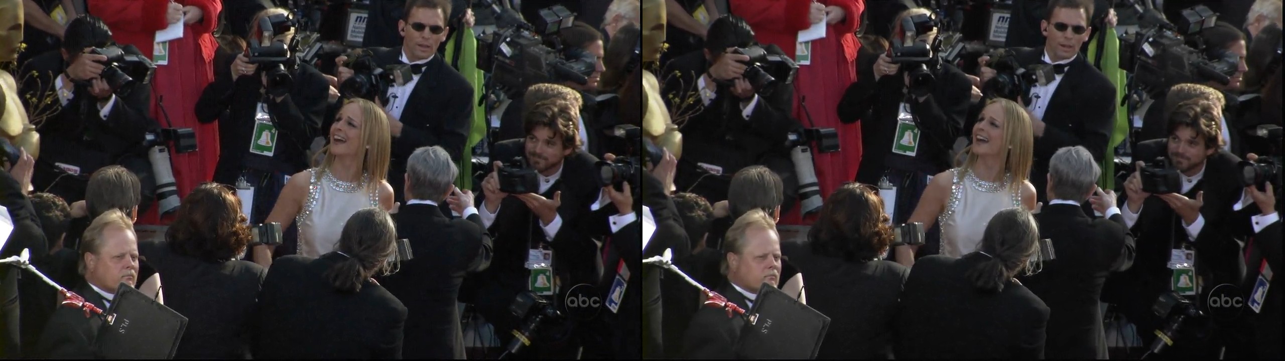

    I downloaded this video and didn't see such artifacts. It has some milder artifacts though:
    [Attachment 38791 - Click to enlarge]
    http://www.zpeg.com/videos/leftraw.mp4
  26. Formerly 'vaporeon800' Brad's Avatar
    Apr 2001
    Vancouver, Canada
    The compression of the side-by-side has smoothed over most of the picture. Plenty of blocks remain where the artifacts are still present. I've cropped the left side of your JPEG and highlighted some of them.
    The ones I watched were the higher-quality individual downloads.

  27. Ah, I see the files you downloaded. They do have much heavier artifacts, like in your sample image. The side-by-side video must have blurred away lots of those artifacts during re-encoding.
    In any case, about all they are doing is applying a little 3d noise reduction with edge protection. Anyone who encodes video knows that will help compression.
  28. Video Restorer lordsmurf's Avatar
    That's what I'm reading here as well.
  29. Member
    Sep 2016
    jagabo, lordsmurf, of course the idea is similar in principle to noise reduction, except that the "noise" to be removed is based on a human visual model operating in the decorrelated 3-D transform domain. So the removal is far more targeted and effective than is possible with filtering, which cannot provide the same level of discrete access to the individual basis vectors.
  30. Member
    Sep 2016
    vaperon800, thank you for your clarifications. To create the side-by-side rendering, I separately made the two compressions, combined them and re-compressed at a higher bit rate, as you suggest. I use a similar technique to make the side-by-side renderings in the online demo. It's a compromise solution...
