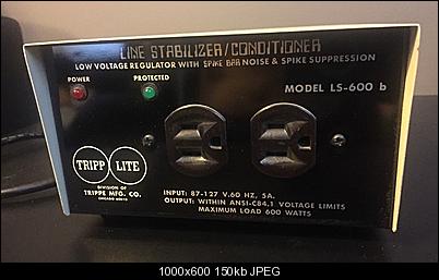

    My house was re-wired with tinsel by the previous owner, so everything is dodgy and subject to EMI to begin with, compounded by the dirtiest, most noisy power feed of anyone I know. Aside from EMI/RFI, the dirty power was causing weird intractable problems with any Matsushita-mfd VCR in the house: within weeks, each new VCR would develop a green tint issue on the left side of the recorded frame. Some 28 years ago I read a suggestion in "Video" magazine to deploy a line conditioner-stabilizer box to clean the power to my VCRs. To my amazement, it actually worked, and all my problems with noise, interference, and weird electronic decay disappeared. I can run a hair dryer, vacuum cleaner and shaver in the next room and pick up zero noise in my video gear. Note these are not the typical surge-suppressor AC outlet strips: they are square-ish boxes, roughly the size of five stacked VHS cassettes, weighing 4-5 lbs due to heavy coils inside (they do not contain batteries and do not function as UPS: all they do is actively, continuously clean and stabilize your AC power).

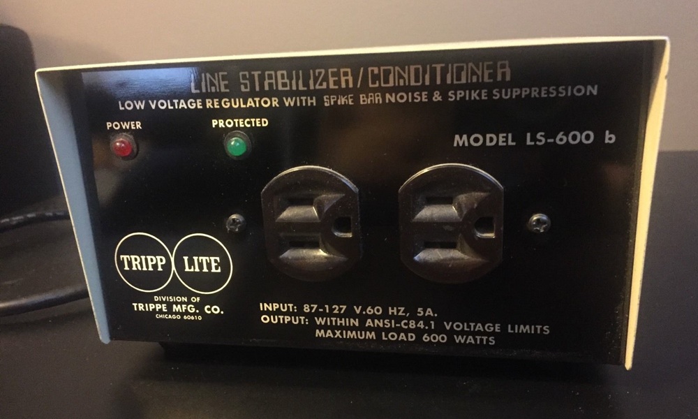

    So if you haven't already tried one, I suggest a line conditioning stabilizer. Mine is an old Tripp Lite 600b, pictured below. My first one, bought new, lasted more than 20 years until its filter caps wore out. I bought a second-hand replacement on eBay 6 years ago, and that one is still going strong. Brand new they cost $90- $200 depending on how many watts you need. This can be a tricky decision: a couple VCRs, a PC, and a flat screen TV can get by on a lower-spec conditioner, but the newer versions of the lower-spec Tripp Lites have inferior filtering compared to the higher-watt boxes.
    The older generations of Tripp Lite, like mine pictured below, have more consistent filtering across the model range. They are also available for peanuts on eBay: some are going for as little as $15 + shipping. Look for one in a plain metal cabinet with "old fashioned" markings as in my picture. Newer, current models are easily recognized by their signature waffle-perforated case: these are much more expensive, and the low-end boxes may not be as effective as comparable older units.
    The two outlet limitation is easily overcome by plugging in a standard Tripp Lite IsoBar surge-suppressor strip with four to six additional outlets. As long as the only things drawing power are a couple VCRs, one TV and one PC, you'll remain well within the operating range of the conditioner.

  4. Some of the techniques pandy mentions are incorporated in the Tripp Lite boxes (when I opened my expired one, thats what I found inside).

    I picked up a couple of LS-600B units. Should have in a week or so. I wanted a four outlet but then I remembered I have a laserdisc player, a Pioneer CLD-V2600, and it has some ground loop issues...there are noticeable horizontal hum bars on occasion. But having tow separate units means portability. And I can move one in another location if necessary.
