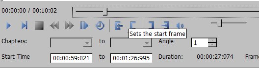

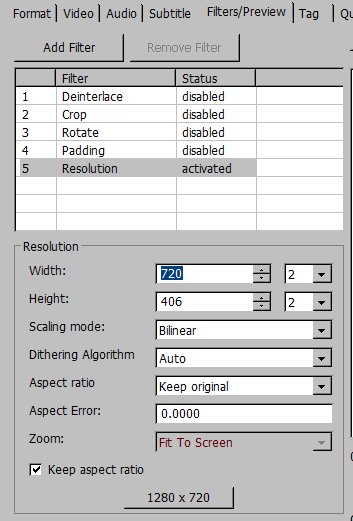

    Further to above, I cannot find (in avidemux) any settings for resolution, frame rate etc. I have loaded the file it and Output Format is AVI Muxer, Configure AUTO.
    Now I see a need to choose a video output from the dropdown. Would that be mpeg4 ASP(xVid4) ?

    There seems to be no Start button for the conversion... or is is the Play button (which starts the video like it'll play the whole thing) and has not asked me for an output path or name.

    I've made mkv/mp4-avi conversions now with Wondershare, VideoToVideo and Avidemux and none have worked, but all using default or "best guess' settings.

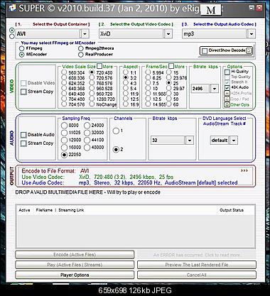

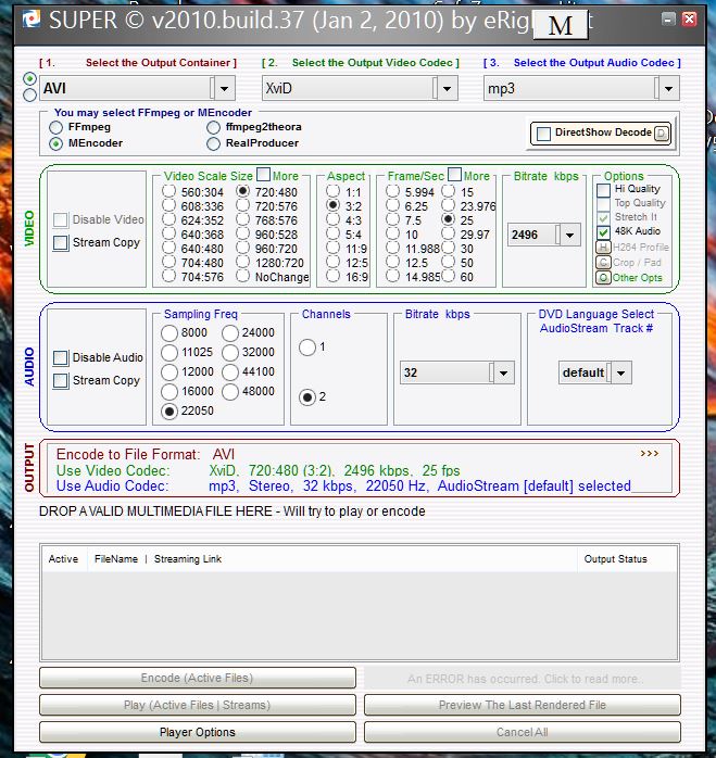

    If all else fails you can try SUPER it has all kinds of presets and does almost every format
    Some here don't like it
    The current version does come with some bloat ware, and you have to jump thru hoops on the website to get it
    Back when I used it, I found it very good at doing xvid and 3g video formats for mobile phones, before Android came around

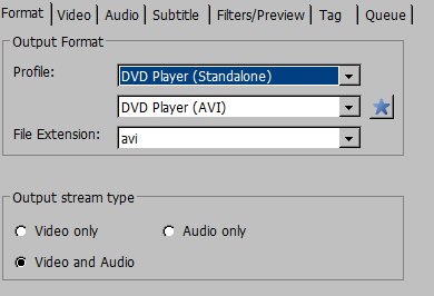

  25. You could try Xmedia Recode.
    On the "Format" tab select "DVD Player (Stand alone)/AVI

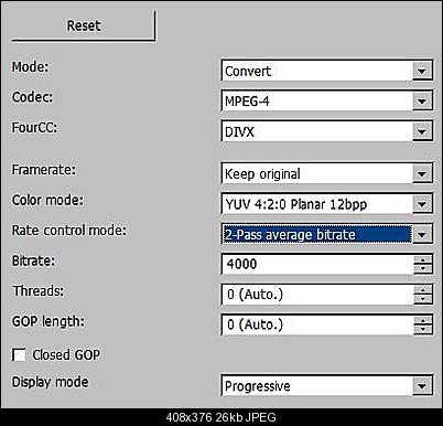

    On the "Video" tab select 2-pass average bitrate and try with a bitrate of 4000

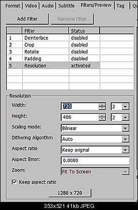

    On the "Filters/Preview" tab select a width of 720
    and use the slider to select Start/end time to make a short clip for testing.

    Thanks for the screenshot of SUPER. May give that a go, after I learn a bit more.
    Videobruger, that's *just* what I needed, thank you for all the screen dumps..
    And - after making the conversion - results were spectacular! Perfect, size, picture - everything.
    Many thanks indeed
