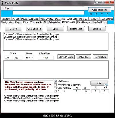

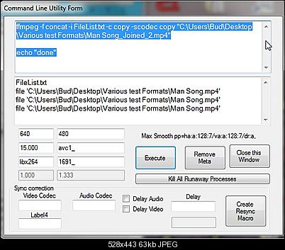

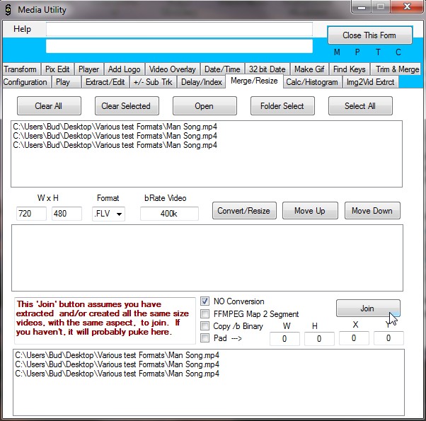

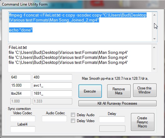

    The files will have to be the SAME (resolution, bit rate, frame rate, etc.) or they will need to be recoded which means some loss. If they are the same I use FFMPEG's Concatenate feature and they play fine in most players.
