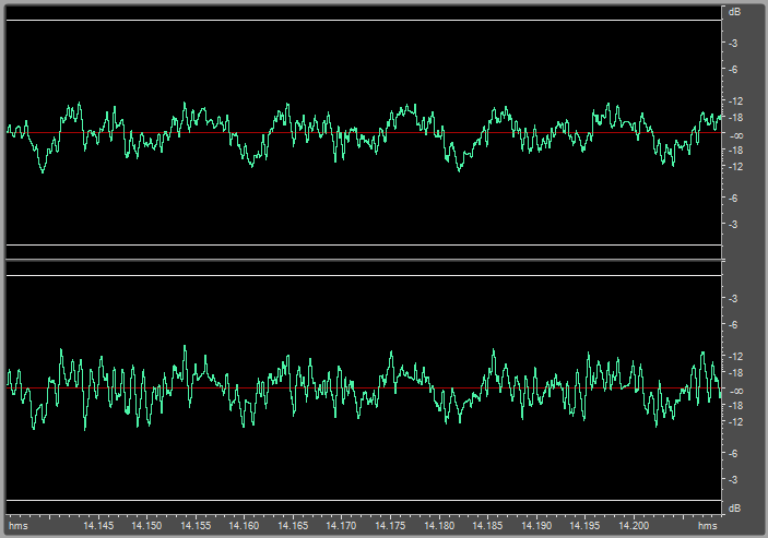

  10. This is not a clipping problem, the problem is periodic silencing of the audio. There are tiny, frequent gaps all over the place. Good luck fixing that. The gaps can be interpolated but I don't know of any filter to do this automatically or how good the replication would be even if it could.
    Aug 2010
    San Francisco, California
    I'm looking at the waveform in Adobe Audition and I can't seem to find those tiny, frequent gaps. Where are they?
  12. Use a spectrograph instead of a waveform. The most obvious is from 8.000 - 8.300 seconds. But even in the waveform you can see inaudible gaps. Notice there's no content above like 10 Hz in them? The rumbling from the big speakers at the concert was interfering with the inadequate equipment.
    If there was clipping, it would look like the second pic which I gained by 15 dB and then brought it back down.
    EDIT: Here's also the spectrographic view of the gaps.
    http://s14.postimg.org/d2w19po1d/spectrogap.png

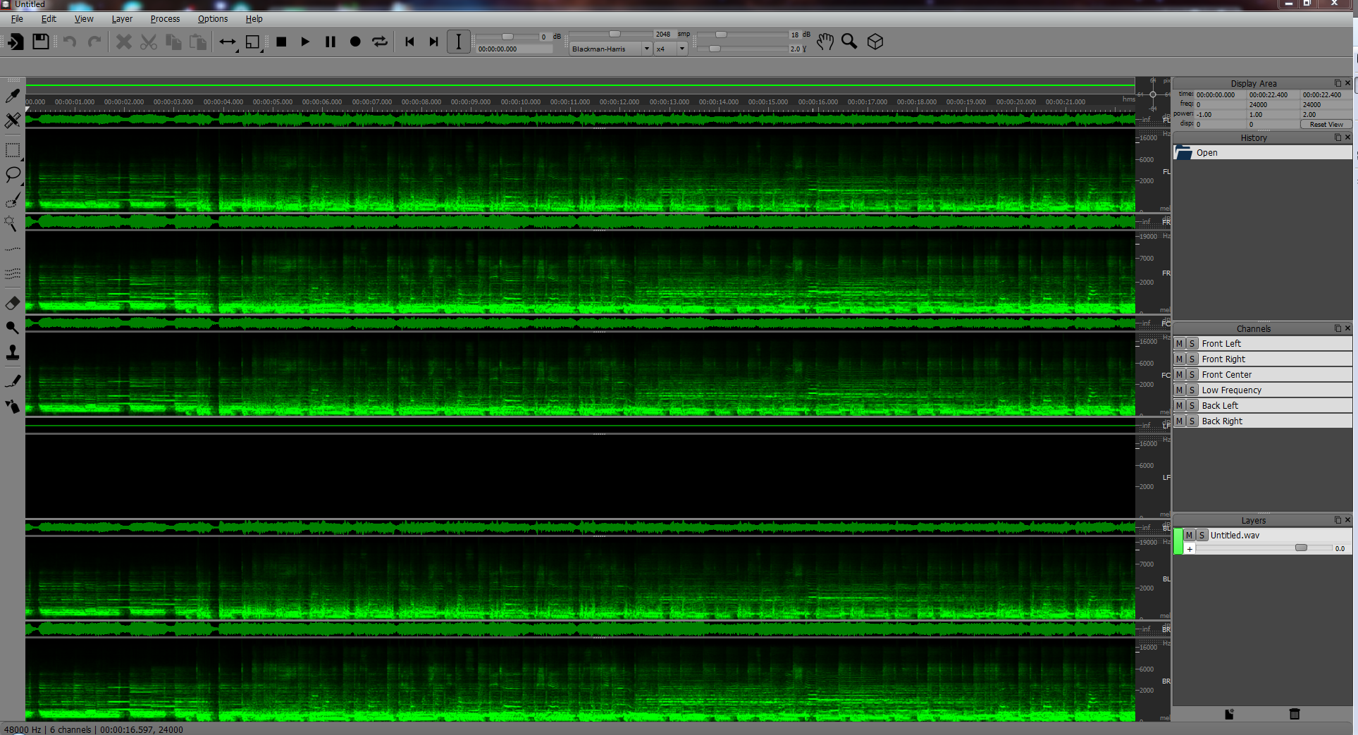

  13. aBigMeanie aedipuss's Avatar
    Oct 2005
    666th portal
    it may have been the sound pressure level overloading the mic capsule in the recording device causing it to cut out each time. you can see the dropouts in a spectrogragh.
