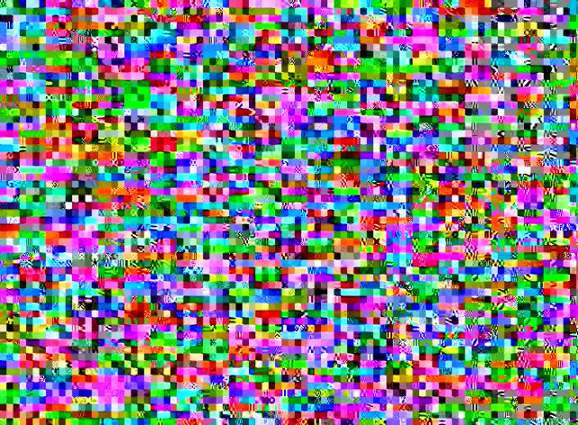

@hello I guess your method works. The video comes out be 720x480 (15:11), close enough to 4:3.
If I don't use killaudio() in Avisynth script, i can see rainbow artifacts every few seconds. I think this is a well know problem of Avisynth.
[Attachment 38602 - Click to enlarge]Last edited by digicube; 20th Sep 2016 at 15:20.
