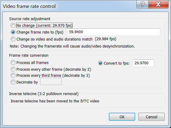

    Video -> Frame Rate...
      Source Rate Adjustment -> Change frame rate to [59.94]
      Frame Rate Conversion -> Convert To fps [29.97]

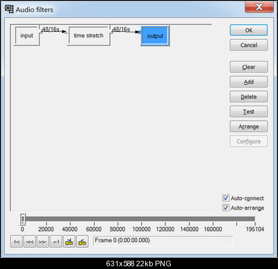

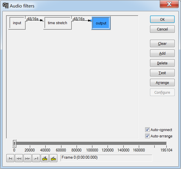

      Add...
        Input, Time Stretch, Output (VirtualDub should automatically connect the filters, if not, connect them yourself)
      double click on the Time Stretch filter.
        Time Ratio [0.5]
