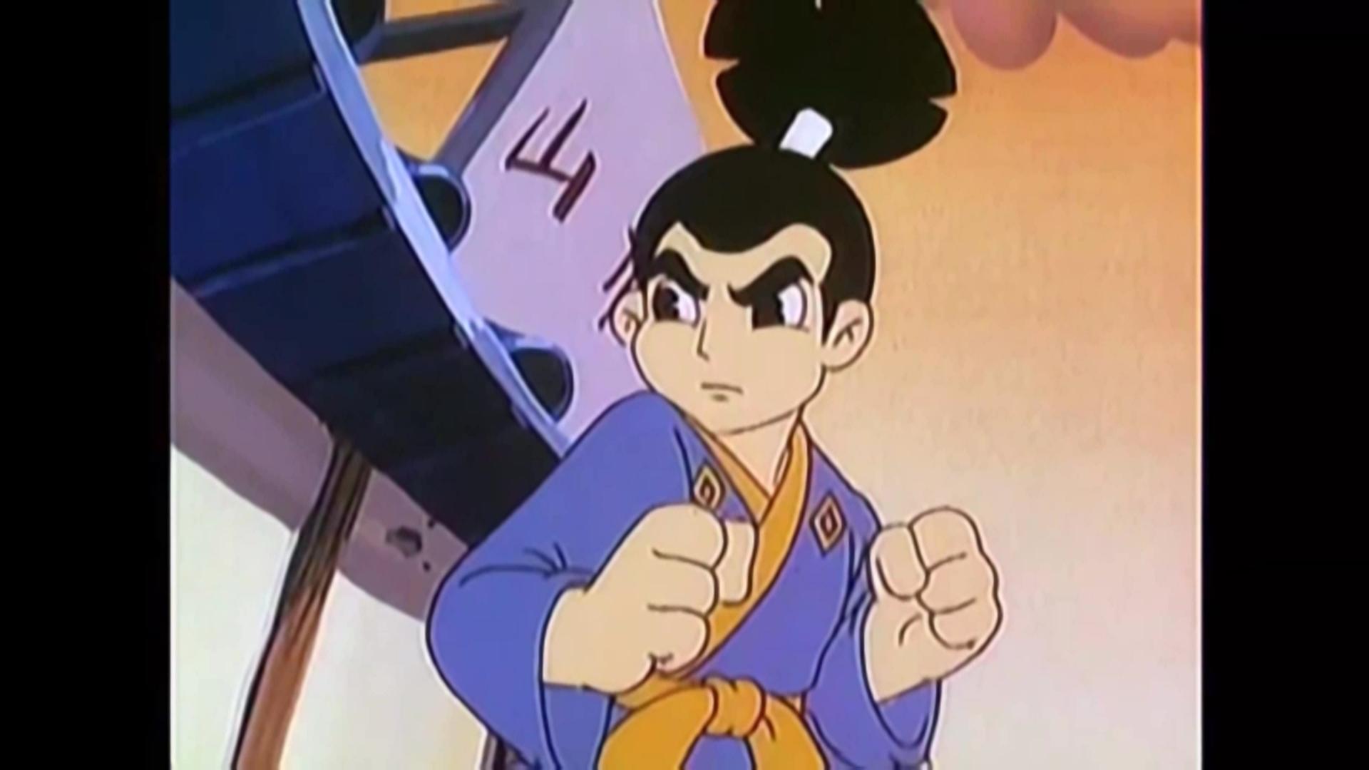

    IVTC didn't work. I'm using a computer that doesn't have the Internet on it, but I have a screens hot of a video I found on youtube that has the same problem. The resolution is lower but hopefully you'll see what I mean. What I'm trying to fix is the same kind of jaggedness that appears on the Ninja guys chin and fingures

  4. This is not jaggies but missing line content (literally line was skipped and signal is no longer continuous) - i would say - badly made deinterlacing - it may be difficult to perform this correctly as usually animation frame rate is way lower than TV frame rate, good deinterlacer (QTGMC? http://avisynth.nl/index.php/QTGMC ) may help but it may be very slow.
  5. Yes, the video was badly deinterlaced (then upscaled). If that's all you have to start with an advanced AviSynth script can help a bit.
    [Attachment 38691 - Click to enlarge]
    But if you still have the VOB source and that source is not already screwed up a proper inverse telecine will work much better. VirtualDub's IVTC filter isn't great. All the best filters for this type of thing are in AviSynth.
    You can use DgIndex or Mpg2Cut2 to extract a short sample from your VOB files. Upload it here. Take the sample from the body of the show (the opening credits are often treated differently than the reset) and include a medium speed panning shot.
