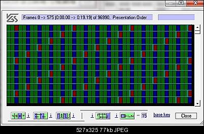

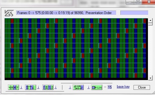

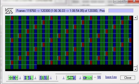

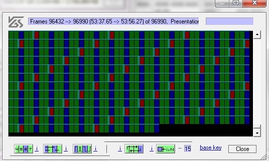

    I used GSpot to get the Visual Gop Structure of both the m2v's.
    Can you tell from this if everything should run without glitches?, they are the m2v's from VOB's I losslessly cut with DVDShrink.
    Looks like both m2v's start on B/Bidirectional frame and both end on P/Predictive frame, but I'm not sure how good/bad that is for smooth playing without glitches!?
    1) start of m2v 1
    2) end of m2v 1
    3) start of m2v 2
    4) end of m2v 2

  8. No, I can't tell anything from those pictures, although I'm sure I could if I read up in GSpot what the different colors all mean. It doesn't really matter anyway, if the joined M2Vs (or DVD after authoring using Muxman) play okay. Also, cutting the VOBs as you did using DVDShrink makes the cut okay. I thought maybe you had encoded them yourself where it's possible to end on an P or B frame, and not an I frame.
    Yes I've always read that DVDShrink cuts only on I frames, but strangely according to GSpot green blocks are B frames, blue blocks are P frames and red blocks are I frames, which means those pictures I put in my last post are saying that both of my m2v's start with B frame and end with P frame, which seems odd considering I've always been told DVDShrink only cuts on I frames (red blocks).

  10. Maybe GSpot is wrong. I don't know and don't much care. If the DVD plays okay, then that's all that matters. I agree that the pictures look screwy if DVDShrink cuts on I-Frames only (as it should).

  12. Gspot isn't wrong. You're viewing frames in presentation order, not encoded order. The order in which frames appear in the encoded stream isn't the same as the order their supposed to be viewed. A presentation order sequence like IBBP is stored as IPBB (encoded order) because the P frame must be decode before the two B frames can be decoded. So during decoding the I frame is decoded and displayed. Then the P frame is decoded but not displayed. Then the two B frames are decoded and the first one displayed, then the second B frame is displayed, then the P frame is displayed.
    Also, when viewing in encoded order open GOPs lead to the last frames of the previous GOP appearing after the I frame of the next GOP. This is because the last B frames of the prior GOP can reference the I frame of the next GOP -- and that I frame needs to be decoded before those B frames can be decoded. An editor that cuts only on I frames leaves those B frames from the prior GOP after the I frame of the first GOP. This is why cutting open GOPs often leads to a few corrupted frames at the start of the clip.
    What I'm not sure about is why the first two frames of the clips are B frames. They could be the orphaned B frames from the previous GOP but all the other GOPs are closed. Or maybe the encoder always starts the first GOP with a pair of B frames.

    Thanks, I've looked at the original DVD's which were made 10 years ago which I received from someone before I made the cuts with DVD Shrink, and both of the original DVD's I have also start with 2 green B frames...
    I have no idea but everything seems to be working fine so I won't worry about it.
