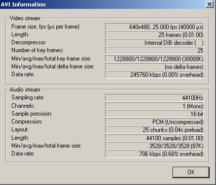

  4. The first frame, using AviSynth counting, is numbered as '0'.
    In addition, the default framerate is 24fps, so:
    BlankClip(25)
    creates a black-frame video at 24fps and 1.04 seconds in length. If, on the other hand, you put this in your script:
    BlankClip(fps=25,length=25)
    That creates a black-frame video at 25fps and exactly one second long. So, I don't know where or how you're getting your information. The included screenshot is from the second script I provided. You can get the same after opening the script in VDub and going File->File Information.

  8. You're looking at the start of the last frame (frame number 24, because numbering starts at "zero"), not the end of the last frame - If the playhead is showing the last frame. But that last frame has a 1/25 second duration , so the entire clip is indeed 1 second.
