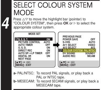

    JVC HM-DR10000EU = Philips VR20D [info] (1999, has "Digital TBC/NR" button, no YPbPr; PAL/NTSC/MESECAM playback; recording supports SECAM-B but not SECAM-L)
    JVC HM-DR10000EK (K = United Kingdom. I would have assumed this is 100% identical to the EU, but the manual doesn't contain the word "SECAM" anywhere and the relevant menu option is removed.** It does play NTSC: "NTSC→PAL" appears on the screen for about 5 seconds." Manual doesn't specify whether TBC/NR is available in this mode.)
    Thomson SCENIUM DVH8090 (France model of HM-DR10000: PAL, NTSC 3.58, SECAM, MESECAM.)
    * I found several of these via their wonderful manual index page.
    The manuals for the DHX1, DHS1, and DH5500 all show the same mockup front panel with a "TBC & 3D" button but none describe the feature, and the actual panels in auction photos don't appear to include such a toggle. I assume that the DHX1, at least, has always-on DNR&TBC, like the US model.
    ** Name:  10kEU Colour System.PNG
Size:  33.6 KBName:  10kEK no Colour System.PNG
