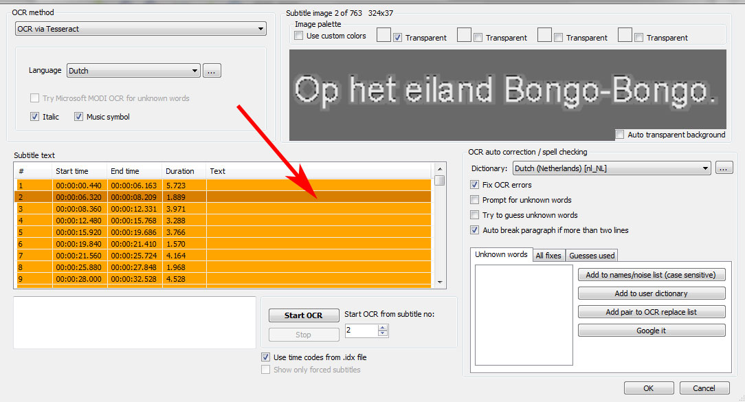

  3. I attach a picture where I show with an arrow the example of how the results are just empty text. Also the picture shows how I have that screen configured and is exactly like the tutorial say and with the correct language.

    I checked step 3 but I donīt see anything abnormal.
    What could be?

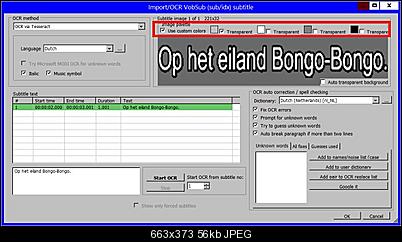

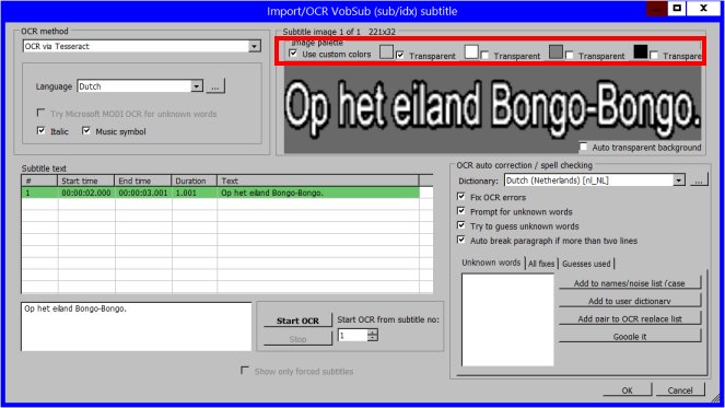

  5. When you have Tesseract properly installed I think you need to "Use custom colors" for the image palette.
    As far as I can tell from the image you uploaded the subtitles use black for anti-aliasing and grey for outline. Perhaps try the settings below. Also I would recommend you tick "Prompt for unknown words" and "Try to guess unknown words"
