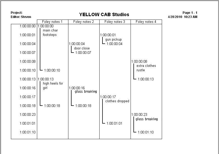

    Mark the beginning and end of the honk and delete - fill the 'hole' with local traffic noise. You could also investigate a 'noise gate' but that needs careful setting up. Attached is an old film sound mixing cue sheet basically just track laying...
