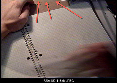

  8. Thanks, though I realize I was not being specific enough:
Name:	line noise.jpg
    I tried to highlight it the best I could but it's so high in the image it may be hard to see - it's like the second or third line down. The issue is not so much the interlacing but the colored lined that shows up at the top of the image, which is consistent through any SP played tape. Watching the video it is visible throughout. I figured I could use hard deinterlacing to get rid of the issue itself unless there's a better solution.
    Thanks for the help so far.
